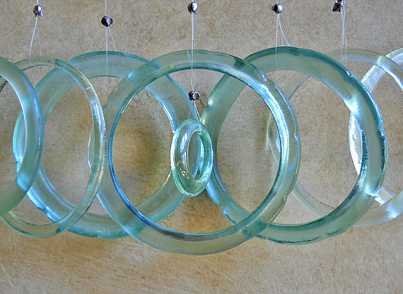

I have a question about a small glass design I want to make as part of a larger recycle project. I am sure everyone has seen the wind chimes (just an example) with rings made from wine bottle slices. But those slices are usually very irregularly shaped and the sides are flat, I believe from being slumped on a kiln shelf.
However, I have seen a few of these rings that have maintained their circular shape and are not quite as flat on the sides (see large rings in attached image). Is this the result of less time in the kiln or an artist who is very experienced with slumping?

As a new artist and being brand new to glass, I have done quite a bit of research on glass, but nothing can replace experience. So, I have looked for local glass artists offering classes. Well, apparently this area is a virtual glass class desert. I guess I am going to have to travel to attend a good class.

less kiln time and the rings were nice and thin to start with. if you are going to be cutting glass on a tile saw do not forget to wear a dust mask or respirator. last time i forgot to do that my chest felt like i had pneumonia for a week. rosanna

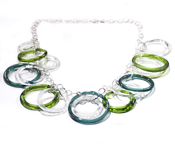

I found great image that is an example of what I am talking about (see the necklace). How are they getting both sides of the ring round?

Thanks for your input. Less kiln time, and very thin rings. I see.

Have you asked the artist?paulas wrote: I found great image that is an example of what I am talking about (see the necklace). How are they getting both sides of the ring round?

I've thought about that too. You could try a plaster mold. That would offer round edges on all sides, but the mold side would be rough.

Lots and lots of ways to get there. The easiest would be to simply lampwork the rings out of rod, with a bench torch. Or you could form them from scratch in a hotshop with a punty, or cut your bottle rings and then firepolish them in the gloryhole (doing fast work to keep them round). Or you could slump into a mold, as Judd suggests. Or cast them with a ceramic or plaster/silica mold.
If they have the same glossy surface on all sides, they're most likely hot-formed. If one side has a less-shiny/more-textured finish, they're more likely kilnformed. You could also kilnform them and then coldwork the result back to an even, glossy finish all over...but that means a heck of a lot more work and/or additional equipment.
In other words, if you want the same glossy finish on all surfaces, there's gonna be a learning curve.![Wink ;-)](./images/smilies/icon_wink.gif)

i think that they juse LOOK round. those look kiln worked to me. i would guess really thin rings fused hot on really smooth kiln wash. rosanna

Hmmm ... still a puzzle to me. First of all, those rings in the first image do not look perfectly circular to me. Nor is their circular cross-section a consistent size. In addition, the diameters of the rings vary significantly - do you think they were cut from bottles? Also, it's hard to tell what the "back" looks like - is it smooth/glossy? Textured?paulas wrote:
... However, I have seen a few of these rings that have maintained their circular shape and are not quite as flat on the sides (see large rings in attached image). Is this the result of less time in the kiln or an artist who is very experienced with slumping? ...
Paula
In the first image, the rings look "notched" at various points around their circumfrences - from whence sprangeth those, do you suppose?
And finally, Paula, you mention "slumping" the rings. I'm thinking you're talking about fire-polishing them after they've been cut from a bottle - is that correct?
I, too, would like to know how to make perfectly circular rings with consistent circular cross-sections and a gloss finish, but the process sounds too daunting to me. Good luck - hope you figure it out.
