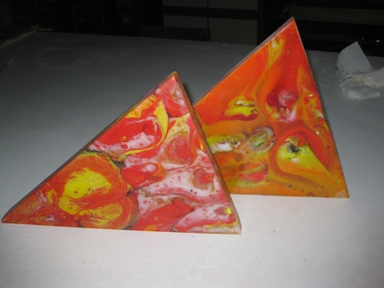

I use mostly opaques. What I do is to use around 50 - 60% white opaque and let that blend with the colors. Too much dark of course turns the whole melt dark.
these are 1 1/2" thick pot melts into a stainless steel former.
I have found that when I mix in any transparent into an opaque melt they seem to alwaysend up somewhere that is not pleasing to my eye.
I have been very lucky that I found alot of white scrap at $2.00 a pound!

It is not clear to me from your post - you do pot melt AND THEN stainless steel mesh melt??? if so - why do'nt you do mesh melt directly??
I am thinking of maybe using BE 0234, which is white , not completely opaque, and perhaps by this achieve more effects.
Also, making triangles is a possibility , however for now I'd prefer using the melt inside a bigger piece, [stripes, maybe. ] I have zillion of 'drawings' of possibilities, yet I want first to gather more melts.
Another idea is to make a bigger melt , say about 12" dia. and work INDISE it with .... God knows what.
Just want to collect some good staff melts to begin with. and the imput about the quantities of transparent and / or opaque sounds Very important.
no....I do a pot melt from one of my hand thrown pot melt pots into a stainless steel form whether it be a square, rectangle, triangle or round. The stainless steel contains the melted glass......using 1/8 fiber paper inside the stainless.
