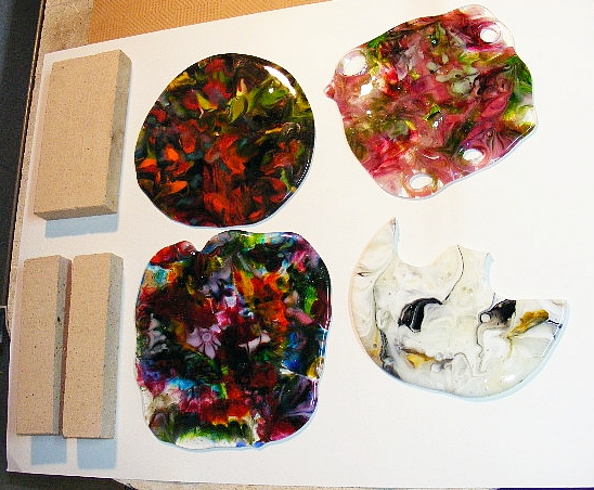

I'll just throw out a picture of some recent melts I did. These were done with a top temp of 1550 with a 1/2" stainless screen. I am going to try 3/4" screen and 1" screen to see if it looks different. They did have some pitting in them but when I refired them to full fuse, they pretty much closed up. On the subsequent firing I fired with a 15 minute hold at 1100 then 100 DPH to 1230 with another 15 minute hold to even out the bottom since I blew some nice holes in the pink/green melt when refiring (all refired right on the shelf).
I now don't feel so bad if I make a piece and it doesn't come out the way I had hoped. I just use the glass for a melt.
BTW - the fire bricks in the picture I picked up at the local brick/stone yard. Originally sized 1-1/2" thick by 4" wide by 8-1/4" long. They cost $1.20 each. I sliced most of them in half with my tile saw for great dams.
