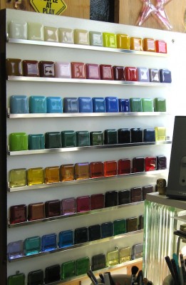

Every time I buy a new glass color, I make a 1.5" tile so I've got color references when I'm designing a piece. So, if you don't already have all of your colors available for reference, that's a good way to use a little space. I still make sure to put small experiments in empty shelf spaces, and then mark them on the back with info so I can recall what technique or whatever I was testing.

The only reason I don't use the rolled edges on my color sample tiles is that I'm a bit anal and like them all the exact same size.Susanbuckler wrote:Valerie

They're mounted on a white board where they sit in mirror rails, so I like the uniform look.

Re: Use of kiln space
They're the strips used to hold mirrors against the wall:

Beautiful! Are these your 1.5 x 1.5 tiles?
They look much larger in the photo
What a great way to keep the colors accessible for reference. I am going to begin to do this with the rolled edges of all glass I purchase. This was such a helpful idea. I was looking at glass tonight to choose colors for a project....would have been so much better if I could have looked at the fired colors instead of referring to the BE catalog

Yep, those are my reference tiles.
