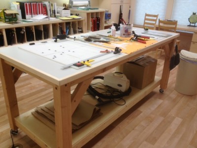

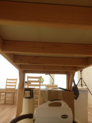

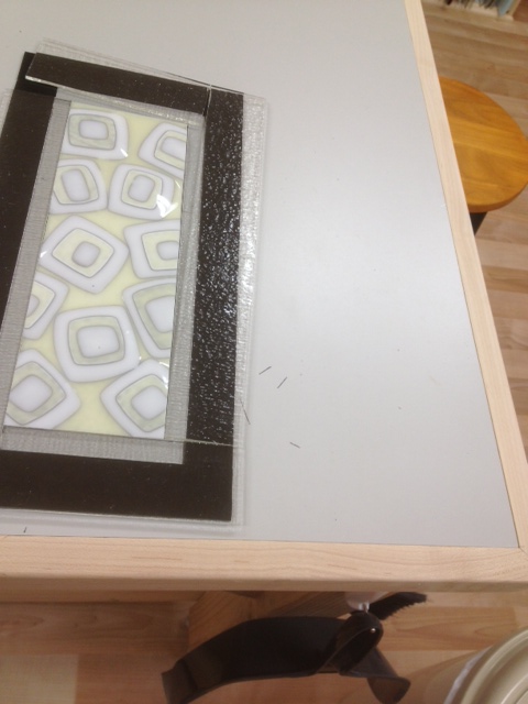

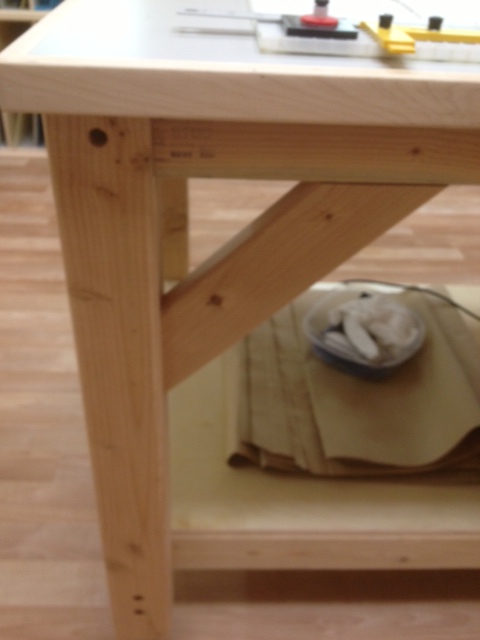

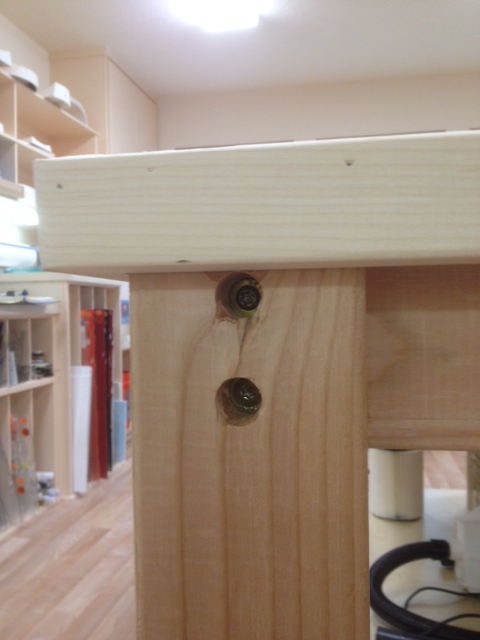

Re: Workbench?
I made a work table that's working well for me. Dimensions of the top are 38' x 86'. The work surface is 38" off the floor, which is about 6" below my elbow height. I had previously been told that the optimum height would be 3" below elbow height, but that didn't let me lean over the work surface as easily as the 6" did. YMMV.
The top is made from a sheet of melamine board that was left over from previous previous work in the house. I put the whole thing on locking casters, but in retrospect that was probably unnecessary - so far, I've never had to move it. (Weighs a ton, though, so the casters may yet come in handy.)

The #1 rule for a surface on which you cut glass is that it must not be concave. This will cause the glass to break wrong every time. Convex is not a problem. Of course I learned this the "hard way"...
My take on bench construction has always been to use framing standards. Dave's is a beauty.
