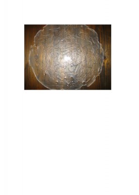

Hi all,,I want to put my scrap glass in the 12 inch ring and make a solid piece of clear ...but I dont know how much scrap to measure out..I talked to the person I bought my ring( Laurie Spray even though I called tooooo early ..sorry Laurie) and she said to cut a circle of glass and weight it,,,well..I would but I dont have a circle cutter and dont want to ruin any more of my clear glass lol..so is there a genius out there who would know how much a 12 inch cirlce of Bullseye tekta would weigh?...or know of an EASY way to figure it out...Thanks so much,,I always know there will be several nice artists out there willing to help a novice.

How would you lay something like up? Wouldn't there be faint lines and shadows all over the blank after it's fired? I've been thinking of something similar with my small mountain of clear.

Hi,,Cate,,yes you have shadows etc...I kinda like it..and when I add "something" else to it...(dont know what yet  ) it will look great
