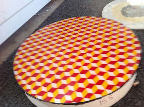

Thank you very much, I appreciate your help. I had just read that in England glass painters used them and I would love to do less cold work and not pick up the landscape of the kiln wash. Like this piece , it took several hours to make and I'm not sure if you can see in the photo- it picked up every aspect of the shelf. Perhaps I'm not experienced enough, and this is normal. It looks like the forward pieces are bigger in the photos, they are actually all the same size. As a portrait artist i really wanted to learn the technique to bring my work to glass. I bought "The Diamond Lights of Hampton Hall -tracing highlighting and silver-staining - the essential practices." They reference their SS kiln shelves and packing whiting.
