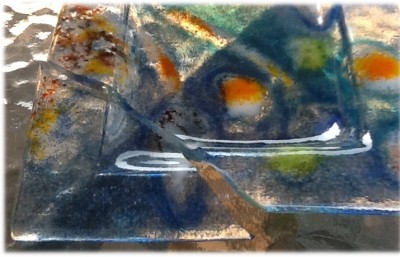

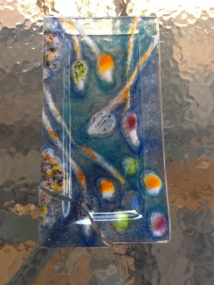

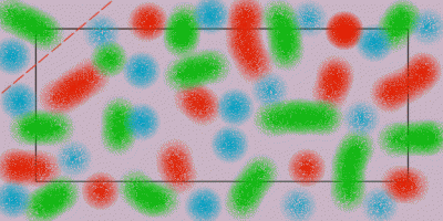

I have a business acquaintance that wants me to try and fix a broken plate/dish for him that someone else had made. It is a rectangular dish approx 6 inches wide by 12 inches long and 3/4" deep. It has an approx 1 inch lip around the plate before it begins to slump down. I have made a rough drawing with dotted lines showing where the break is on the plate/dish. It looks to be a single clear layer with some frit and stringers fused into it.
He is a denturist so I asked him to make a mold of the plate which he has done perfectly. My question is can I now put a dab of super glue to hold the break together and put the plate into the mold and take it to a tack fuse to mend the break. The break has gone across the corner but also has some of the depth of the slumping to it. Sorry that's the only way I know how to describe it. Can this be done or any other suggestions?

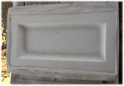

Second, what's he making the mold of? Refractory plaster? Ceramic slip??? It must be able to withstand the heat of the kiln, and something simple such as plaster of paris isn't stable enough at those temps. It could crack and then the glass would take the impression of the cracks.

He gave me the plate today, I just measured it and it is 6mm thick. Looks like it was a piece of clear then frit added and clear capped. I thought there was stringers in it but there isn't. I asked him how it got broken and he said he put it in the dishwasher and when he took it out of the dishwasher it was broken. So do you think it was a stress crack and that maybe there will be more? I think I will just try glueing it back together. I forgot to add, I think he used hydrocal for the mold it is not pure white like plaster of paris, I have it out in the sun drying now as I could still feel a lot of moisture in it. He makes and repairs dentures and makes the molds for them, he has a tiny kiln himself so whatever he uses for his molds for teeth is what he has used for this mold.
Nice piece. I like the gluing idea, too. But if it's a thermal shock fracture caused by poor annealing, which it sounds like, you'll want to dry-fit and make sure the pieces still fit together. Sometimes the shape of the broken piece changes slightly as the stress is alleviated. If they don't fit exactly together, there's less chance of saving it with a runny adhesive like HXTAL--you'll need a gel-like adhesive that fills in cracks, or a way to set up the HXTAL to also act as filler. If they do fit, go for it.
More than likely there won't be another fracture unless you really push it--the stress is now alleviated. But tell the dentist to keep artglass out of the dishwasher unless it specifically says "dishwasher safe."
The mold will work fine in the kiln, but your dentist probably used to much smaller molds (i.e., teeth) that may require a little less drying time. I would let this dry for a couple of days in the sun, but still run it through the kiln at around 240F or so for several hours, until a mirror held up to a kiln vent no longer fogs. Let it cool down completely before using.
You could use the air-dried mold, btw, to help hold the pieces in the right position while the glue sets.
