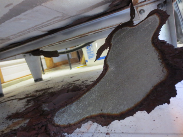

I have had my Evenheat 2841 kiln for about 9 years now. Three years ago the top caved in when the rusted banding gave way. Just recently the bottom metal started falling off. Now the kiln bricks are exposed. The bottom is about 80% rust. The rust that fell off is chunks and powder. I am curious if this has ever happened to anyone else. I have my kiln in a shed. I run a dehumidifier in the summer. I live in North Florida and yes it is humid here. I am sick about my kiln and, of course, this is a very busy time of year for me. Evenheat was kind enough to send me a new lid 3 years ago, however, they told me now there is nothing they can do for me. Am I the only person this has ever happened to? I have more pictures.

outdoors in a shed in Florida seems like a very harsh environment for a kiln. You're dealing not only with humidity but most likely, also salt (which is very corrosive).

Salt? I live about 10 miles from the coast. Its a totally enclosed shed. How could salt air be affecting what's in my shed? I know fellow fusers that have Jen-Ken's that have been in car ports for 30 years with no rust.

I doubt it is the kiln type to blame. Thousands of Evenheat kilns have not rusted like this. It has to be your specific environmental conditions!
Re: Evenheat 2841 Kiln rusted out
Put a sheet of stainless steel between the kiln and the stand. Or get rid of the stand, set up a platform of cinderblock and put the kiln directly on that.

Yes, I can definitely put SS on the bottom. The lid is rusting again and the jacket. Also the stand. Honestly, mentally I am ready for a new kiln. I want to make it until the first of the year with this kiln. I know my fire schedules and don't want to spend the time right now getting used to a new one.

Hi Carol, I live over in Quincy - did you know that locally we have formed a new glass guild? Check out the Southern Art Glass Alliance. At any rate, I have extremely rusty denver kilns - one day I went to scrape off some of the rust on one in preparation for painting it and discovered that there was no metal any more, only rust. So...it's been that way for a few years now. Still fires just fine. The steel (none of the kiln mfrs use thick or high-quality steel IMHO) is just there for aesthetics (such as they are). I wouldn't worry a bit. If it bothers you, do what Marty suggests. And yes, BTW, Florida air does have salt, even when you're miles from the coast.

Thanks you all...I appreciate all the posts. I am over the initial shock. The kiln is still working fine. I have made a lot of money with that kiln and when I need to I'll buy another. Several other fellow North Florida glass people have said their kilns also have rust. I guess the kilns don't like the humidity either. Cheryl, I do know about SAGA. I am friends with several of the members. Thanks for your post.

I used to live in Hawaii several miles from the ocean. Refrigerators, washers, and dryers rusted quickly. Anything outside rusted even faster, of course. Cars left outside developed holes in the sheet metal. So, perhaps humidity is the biggest reason for the kiln rust. Kilns that fire wet greenware also rust out quickly.carol n. wrote:I have had my Evenheat 2841 kiln for about 9 years now. Three years ago the top caved in when the rusted banding gave way. Just recently the bottom metal started falling off. Now the kiln bricks are exposed. The bottom is about 80% rust. The rust that fell off is chunks and powder. I am curious if this has ever happened to anyone else.
As Marty suggested, slide a piece of sheet metal between the kiln and the stand.

Well... you were asking for suggestionscarol n. wrote:Salt? I live about 10 miles from the coast. Its a totally enclosed shed. How could salt air be affecting what's in my shed? I know fellow fusers that have Jen-Ken's that have been in car ports for 30 years with no rust.
And actually... It's not such a stretch as you think. Salt water evaporates. The salt turns to dust, it can then be carried on the wind, or redeposited by rain.
