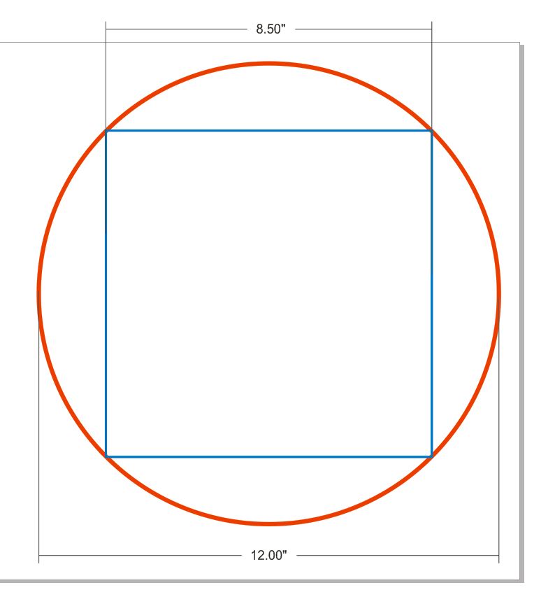

I know that there is a formula in the archives, but I can't find it.
A formula to determine the maximum square out of a circle.
Ie 12" diameter circle will get a ?? square

A 12 inch diameter means the square can only be 12 inches from one corner to its opposite (the diagonal). Coincidentally, that would be the hypotenuse of a right triangle--what you want to find is the length of one of the legs of that triangle. If you dredge up your old geometry books, you'll find a-squared + b-squared = c-squared, where c-squared is the hypotenuse of a right triangle. Both legs should be the same length, so...
a^2 + b^2 =12^2
a^2 + b^2 =144
a^2=72
a= sqrt of 72
so a=8.5 or thereabouts
I'm doing this in my head, so somebody please check my math...and there may be an easier way to find this, that's just the only one that occurred to me.

Your math checks.

Yep, I draw it on the computer.
Easier than the math.
