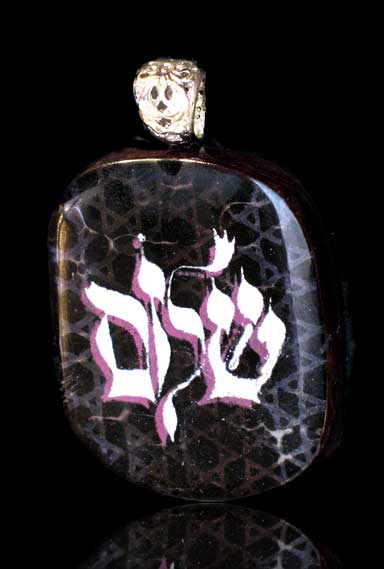

Note:Our black should give a very crisp color if applied correctly. you can test fire by doing a screen print image on a clear piece of glass and firing.
This example: was printed in purple and did not show up well. Added another layer of printed and offset in silver to emphasize the image. Barry
