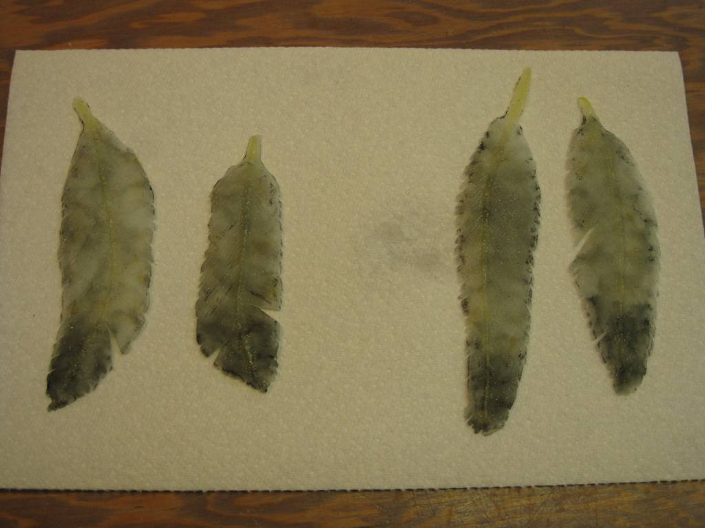

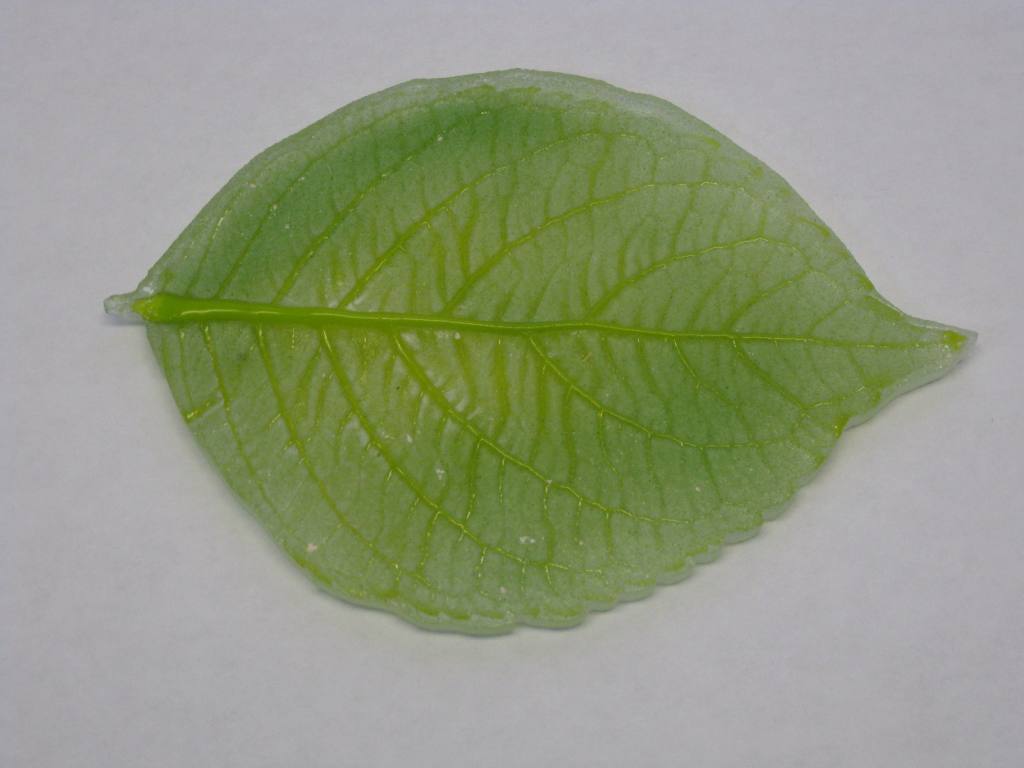

This is the program I used for the two pieces shown:
105-88c-60
277-593c-20
166-787c-50
166-787c-10
9999-515c-120
off
105-88c-60
277-593c-20
166-787c-50
166-787c-10
9999-515c-120
off
