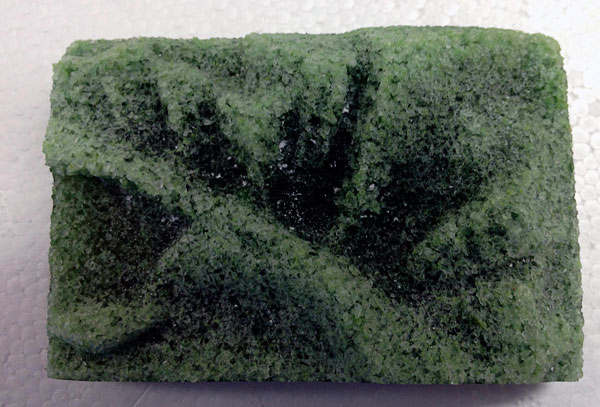

Yep, I know (and you're a wizard at it). I use it infrequently enough that I have trouble getting the right amount on, and for what I'm doing, usually, even a few small bubbles are a problem. Plus, since I do pate de verre where you WANT lots of small bubbles, I'm really sensitive to it.carol carson wrote:Wow, I didn't realize you didn't like that technique Cynthia. I use it all the time to cap my drawings. You are right though, I use it just as a thin even dusting.
I think it's much less likely to be a problem when you're sifting across larger, flat panels of glass--it's easier to get an even coat without falloff. I tend to work with curved, dimensional surfaces, especially with small pendants, so I get a bunch of powder on the surface and it slides off the curves. That makes the contrast (and bubbles) really obvious.
Usually, devit on a surface doesn't bother me much, because I coldwork so extensively anyway. I'm presenting a fresh, clean surface to the heat, so I'm not really giving the devit a chance to grow. When I do get devit, though, it's spectacular. Like this cityscene: Which SHOULD look like this: That one, not even coldwork would save.
