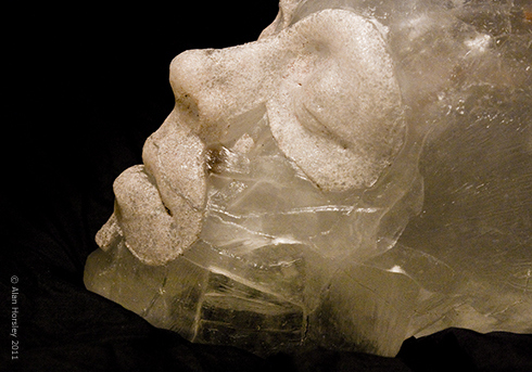

I know this combination of pate de verre and casting is not common but it makes me curious, .
i didnt see a lot of works with combination of casting and pate de verre.
I found on google this interesting artist
http://alanhorsley.wordpress.com/about/sculpture/
i saw his interesting work using the combination of pate de verre and casting.
are there other glass artists that use this combination? i mean fire together the cast piece with the patedeverre parts, not gluing the parts together??
i will be happy to see their work!.
oritt

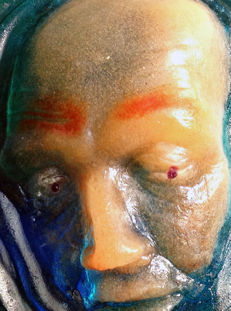

Re: combination of casting and pate de verre
Actually, the face and hand retained the pate de verre quality, about like alabaster:
There were a few odd effects, though; the red-brown dusting I gave the eyebrows did migrate a bit, as did the pupils, and needed to be cold worked. Typically the pack doesn't move at all in my faces, so that was a little unusual. Also, the pate de verre WAS more translucent than usual, so that the strongest blues behind the face show through.
I attributed that to the long process at 1525F. I felt I needed that long and hot to ensure that the billet colors came down and blended, although it probably didn't need as long as I gave it. I've had a couple of these, though, where in thicker areas the billet didn't quite fill and flatten as it should, probably because I'm baffling the mold from the end elements with firebrick.
You could preform the billet and do your color mixing in a background mold that lacked the face/hands, rather like forming a giant billet. Then you could pack the face and hands in the real mold and add the "billet" on top, fire them together so that the pate de verre sintered and then attached to the background. I'd worry that the interface would be obvious, but this particular piece is very single-planed anyway, so it probably wouldn't matter. But it would be a lot more work, and there would be increased danger of bubbles.

The close up picture of the face does show pate de verre texture.
thank you very much cynthia for the great tips and explainations.
