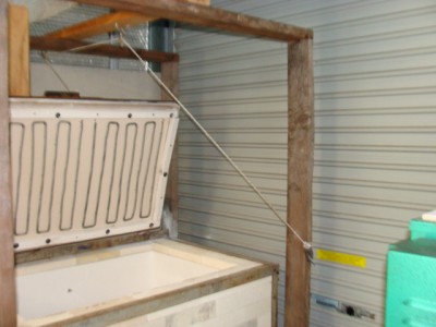

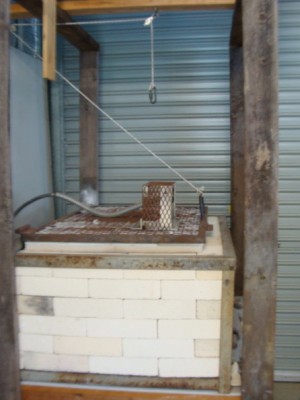

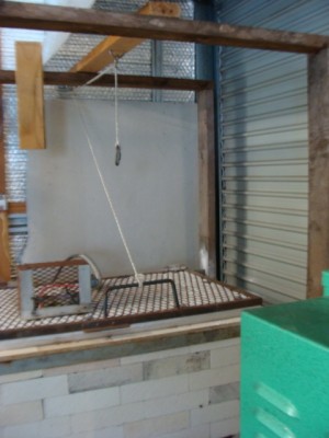

My brick kiln has a home-made lid-lifting device, super simple, some 2x4's, rope and a pulley. It's not pretty but it's functional and requires minimal effort. Hooking a loop in the rope over a nail in the framework holds the lid open. It is operated by standing in front of the kiln. This kiln is now in a corner so access is only possible from the front and one side.
It started out with a counter-weight but that went down behind the kiln and collided with the thermocouple. The lid is not so heavy as to need a counterweight so that was abandoned.
The kiln is on a wood stand on castors with a sheet of cement board under the kiln. The 2x4 framework for the lifting device is attached to the wood stand.
If you'd like a pic I'll take one and post it. Jen

Hi Jen.
Would you please do this?
Thanks.
jim
Thanks.
jim

Jim, as requested, here are the pics of the very low-tech kiln lid lift-assist. Hope that helps, Jen
						Re: need help deciding on which large kiln
Tried to add to the message after I'd added the pics but couldn't. (Told you I was strictly low-tech.) Anyway, just wanted to say that the cover for the electrical box on the lid is temporarily off. Don't operate like this at home. It just had the fibreboard in the lid replaced and the elements reinstalled.
The framework was hastily erected from material we had around, 2x4's from concrete forming. The short vertical board is there to stop the lid going right back and smacking into the sending unit which is mounted on the wall behind the kiln. If I want to quickly peek in then I just raise it enough to see in without fully opening it. Hope that helps.Jen

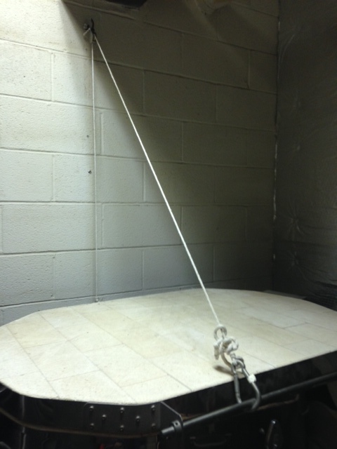

Jen, here is a photo of the counterweight system i made for my oval kiln. The weights were old gym weights with some sand to get the perfect balance. Very simple and very effective.

Very tidy! I'd have preferred not to have the wood frame but it was necessary because my workshop is corrugated metal so putting a hole through the wall is not a good idea. Also, the kiln will eventually be repositioned when the workshop is extended so the frame can go with it. The walls will still be metal. There currently isn't room to pull the kiln forward enough to make room for a counterweight that won't interfere with the thermocouple. In the last workshop the rope went up to a low beam. Jen

Several thoughts-
The counterweight does not need to be anywhere specific, you could add another pulley (or 2) and direct the weight someplace else and it would still work.
I don't like the idea of anything flammable or meltable near that oval kiln lid. The outside temps on that oval kiln lid get at least hot enough to char paper and melt plastic (how do I know?!). Use garage door cable instead.
Jen- "The kiln is on a wood stand on castors with a sheet of cement board under the kiln." What's the outside temp at the bottom of the kiln? I found that 2 layers of cement board (supporting a brick kiln bottom) is barely enough. The stuff is not refractory and when I rebuild the kiln I'll change it out for something better, or add another layer of brick.
When I put a kiln on a wooden bench, I use hollow cement blocks between the wood and kiln (holes aligned horizontally).  This has worked fine for me.  You can store stuff in the cement block holes.

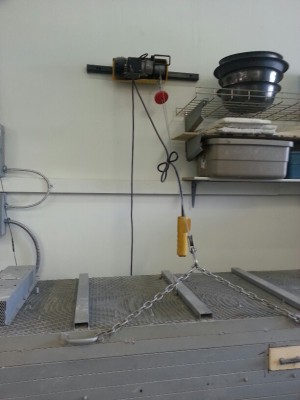

I tried a counter weight system once but found it too finicky. So I bought a hoist
Much easier to get the lid an inch or a foot up.
Thanks for the heads up, Rick. I know the lid and sides don't get hot ( unlike the 'full metal jacket' small kiln). I can always put my hand on them. The underside may be a different matter. There is a sheet of steel under the brick bottom, inside the angle iron frame. The kiln is lined with 1/2" fibre board on the sides and bottom, but I've never felt under it so can't say how hot it gets. The air around it doesn't get warm. It only has top elements. Looks like a stand rebuild will be necessary as it would be too high and maybe too heavy for the stand if bricks or cement block is added. That said, it's been operating like that for years, even experiencing one serious overfiring when an 'industrial electrician' installed the mercury switches sideways so they didn't shut off. I really don't want to take any risks so will look into changing it. Thanks, Jen
