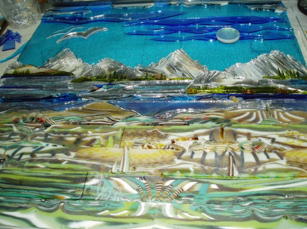

One of 5 panels to be created at Uroboros Glass Company Residency in July! More layers of clear to go on this but transporting layers of cut pieces and the finished cut panel is a trick in itself. Had to get a PaPs Manifest done tooo so going over the border will be alittle easier this time I hope. I just wish it was not so hard to get into the USA but hey! my motto is do not sweat the small stuff. So off I go to finish the other panels before I arrive there as time will be short to fire and then slump this piece called: "WETLANDS SANCTUARY" . Look so forward to seeing a few of you while in Portland too! Leslie

Thanks for the encouragement. I am working on the next 2 panels to come down with me to the Residency. Fun for sure . Here is the beginning of number #2

1. Beautiful! Really like it
2. IMHO, NOT too much cream. I would have left it as is - - - - -
3. Good luck!
3. Good luck!
Re: Mistakes and Taking Risks
Hi Havi,
Well sometimes I get worried about cream or white in the middle of pieces reflecting heat away as dark colours absorb more heat and light ones keep abit cooler sometimes Sooooo! I had already changed the piece ( and am actually a lot happier with composition now
) so let me know what you think
Here is the section that \I changed and am much happier
