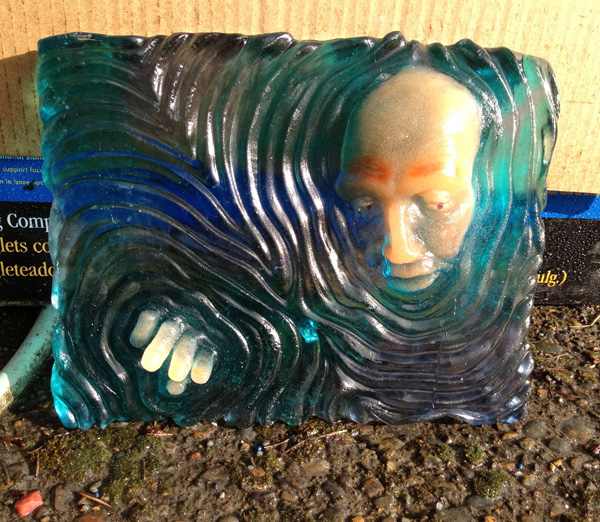

This is wet and dry pack frit for the fingers and face, billet casting for the background--the mold lifted off the billet perfectly and gave me the detail I wanted. The PdV areas tended to stick and had to be power-washed away. That's just the nature of the beast--fritcasts expose a lot more glass surface area to the mold, and if you're packing the powder against the mold surface you're both abrading and integrating the grains with any plaster coming off the mold.

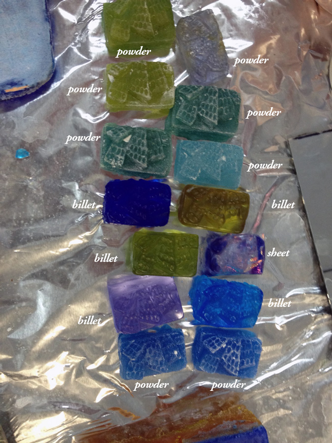

I don't think that's the problem here--couple of possibilities. First, if you're using larger frit sizes (fine to coarse) against the mold surface, grainy distortions are far (FAR) more likely. I always use a layer of powder at the surface, even if 1-2mm in I'll be using larger frit, and it preserves the surface and detail. Here's a comparison using identical waxes with different form factors of glass (sorry for the lousy image). As I said, the powder pieces have a more matte finish and you can still see plaster stuck to the surface. The billet pieces don't do that.

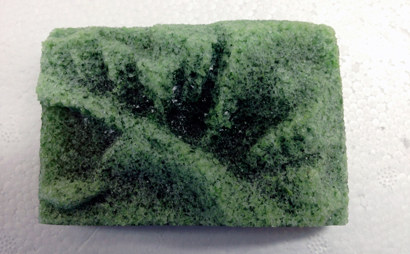

The second possibility is that you've got devit. Frit casts are far more prone to devit simply because there's more surface area from all those particles, and any grains of plaster that embed in the surface can act as nucleation sites. Extreme devit looks a lot like piles of sugar crystals. This is a badly devitted piece from the same molds as above:
I've found that wet pack is a bit more likely to produce devit than drypack, possibly because the mold's a little soggier. (If you can touch the mold with your finger and have it come away wearing a milky coating, you've got problems)
If I see devit I (a) look at my schedule and potentially reduce my processing temperature, (b) am very careful not to abuse the mold by oversteaming or abrading it, (c) ensure I've allowed at least 24 hours for the plaster to cure before I start a steamout (or if I'm using a direct clay model, that I'm using wet clay that can be easily removed), and (d) examine my mold-making process and make sure that my mix isn't too wet--wet molds are weaker to begin with, and I've found that with steamout, they're FAR more likely to devit.
