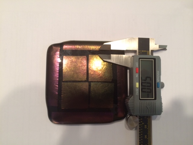

I have attached a photo of one of my test pieces. This was made with three layers to encourage the glass to flow beneath the irid and pull it apart. I got 5mm movement but as you can see no cracks in the Irid. I liked Valerie's suggestion of firing hot, and Jeanice's thoughts on scratching. I will work them into a test piece next weekend.
Thanks to all for your thoughts and feedback
Bob W
