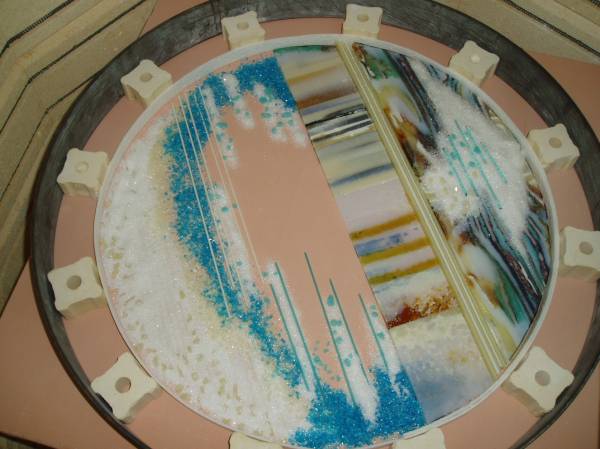

Well I have been having a wonderful time experimenting with Reactive Glass of late and created a large thick colour bar that I sliced up ( sad to say my saw pump finally quite on me
) but could not waite so hooked up a hose and kept on going) Anyways, really excited to try a deep slump vessel that is totally different from inside outside. I am really excited also to create a large cast piece that will slump in a large mold at my friends place in Elkford , B.C. Can hardly waite for that. But for now , here is the beginning of the deep slump piece. Do not usually like to use fiber but did not have the right Zircar mold so here goes nothing
Re: Creating Deep Slump Reactive vessel
**All the slices are from the same colour bar so I am pleased that I could create a few pieces out of it.

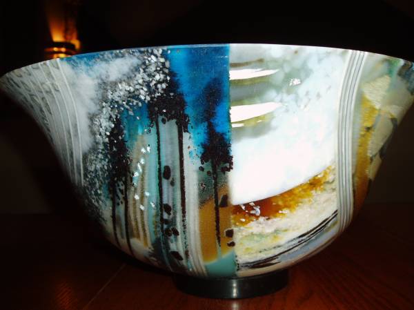

(the fusing process went nicely , now it is in the kiln on the first slump before the next 2 deep slumps. ) I have found a BEAUTIFUL piece of Maple and have cut into 3 pieces and am using them for the bases. It is so lovely and soft and a nice match for the vessels . So much character in the wood fits with the gold and lines in the glass. I look forward to seeing the dark inside and the lightness on the outside. When the gold stretch's it will hopefully looked stretched and match the wood. Here is another vessel that is not a deep slump on a piece of the maple
First slump is good , now second deeper slump is set up and will go on tomorrow . The large flat panel will be finished soon and ready for flat firing. Hope I will be able to slump it though as it is alittle large for my kiln , and pray to slump in friends kiln. That would be so great. Les
Well patience is a friend today . I am happy with the very different look from inside to outside and the reactions are strong. BUT I love the gold and silver side.

I love. love this vessel! The stone base is perfect for it too. I enjoyed seeing the photos of the layup and then being able to match them up with the finished product. Thank you so much for sharing the process.
Thanks so much Vonon. The pictures are poor but I only have an old camera that is not a good one , BUT at least you can get the idea of how it was inspired . Les

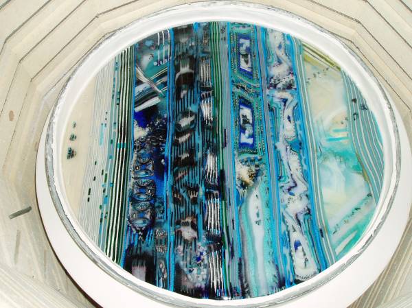

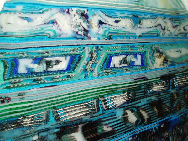

The flat firing was nice, now to slump .
I hope when the piece is slumped it will show the underside as it is really interesting . It is flowing nicely into the name of the Series " Glacial Striations"

New 24inch vessel flat fired. Now to prime the deep mold out of MM6 and try a one firing slump. Hmm! The cane that I created with reactive glass (in an old MM6 mold I cut a 2 inchs square out of) for a drop in the large skutt kiln has slices into this piece. Les
