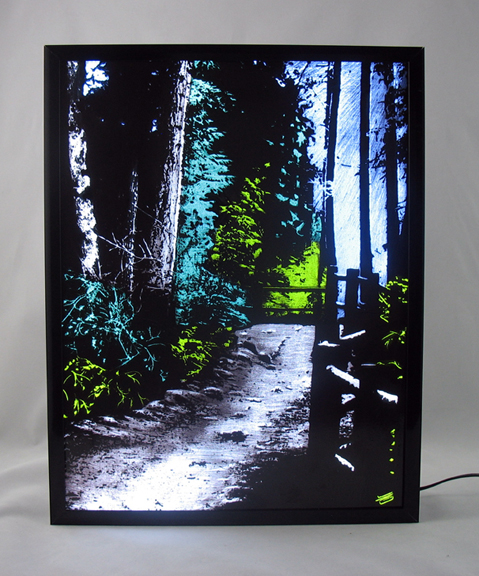

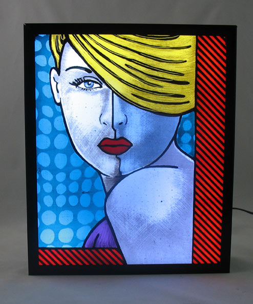

I have been working on this problem for several months. Many of my newer projects involve screenprinting, tracing and matting - the finished piece needs to be either in a window (not always possible) or backlighted. My solution goes as follows:
I use a Nielson#35 frame (Americanframe.com) to construct my lightbox. Glass art is backed by a piece of 40%white acrylic sheet cut to size - this evenly distributes the light. LED light strips, dimmer, power adapter and 12VDC connector came from Hitlights.com. A piece of Masonite whiteboard is used for the back of the lightbox, with the white facing inside to provide a good reflective surface. I glued strips of white foamcore around the inside of the frame, and attached LED light strips all the way around to provide illumination (had to use superglue - self-adhesive tape did not work at all!). Frame was assembled (with included hanging loops) and then glass, acrylic and backing were inserted. Dimmer was plugged into 24W power adapter ... and there was light.
Being my proactive self, I have created an instruction sheet in MSWord - it has more details than the "Reader's Digest" version above. The finished lightbox is not that difficult to put together, and I would estimate the total cost of a 10" by 12" somewhere between $80 and $90. If anyone is interested in detailed instructions, PM me and I will email the file.
