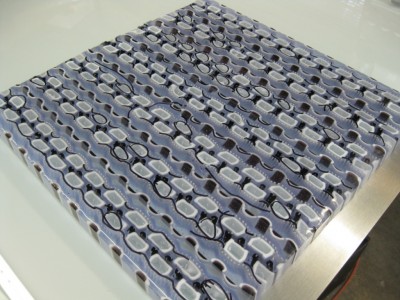

I was recently working on a piece about an inch thick and 17 by 17 inches in size. The glass used was Bullseye opaque white (sheet and stringers), 0013, along with light neo-lavender shift and crystal clear. On the third firing I experienced a dramatic shift in compatibility by the opaque white. The piece fractured along just about every white line, and within a number of squares surrounded by the white. None of the firiings were above a standard full fuse temp. I am aware that people have experienced compatibility shifts with Bullseye's dense white. Anyone have a similar problem with the opaque white? Tim

The initial firing schedule prior to cutting with the tile saw was as follows:

Black markings on the attached photo show the patterns of the cracks.

In short, I probably could have gone lower for longer. This piece started as basically a large pattern bar stacked 2 inches high. The long hold allowed it to level out and rid itself of most of the bubbles, the final thickness being about an inch and a quarter. It was then cut on the tile saw to one inch strips, flopped, then in for the second fuse. The first fuse cut like butter on the saw, so I did not suspect any anneal issues. The results of the second fuse were quite a surprise. Tim
