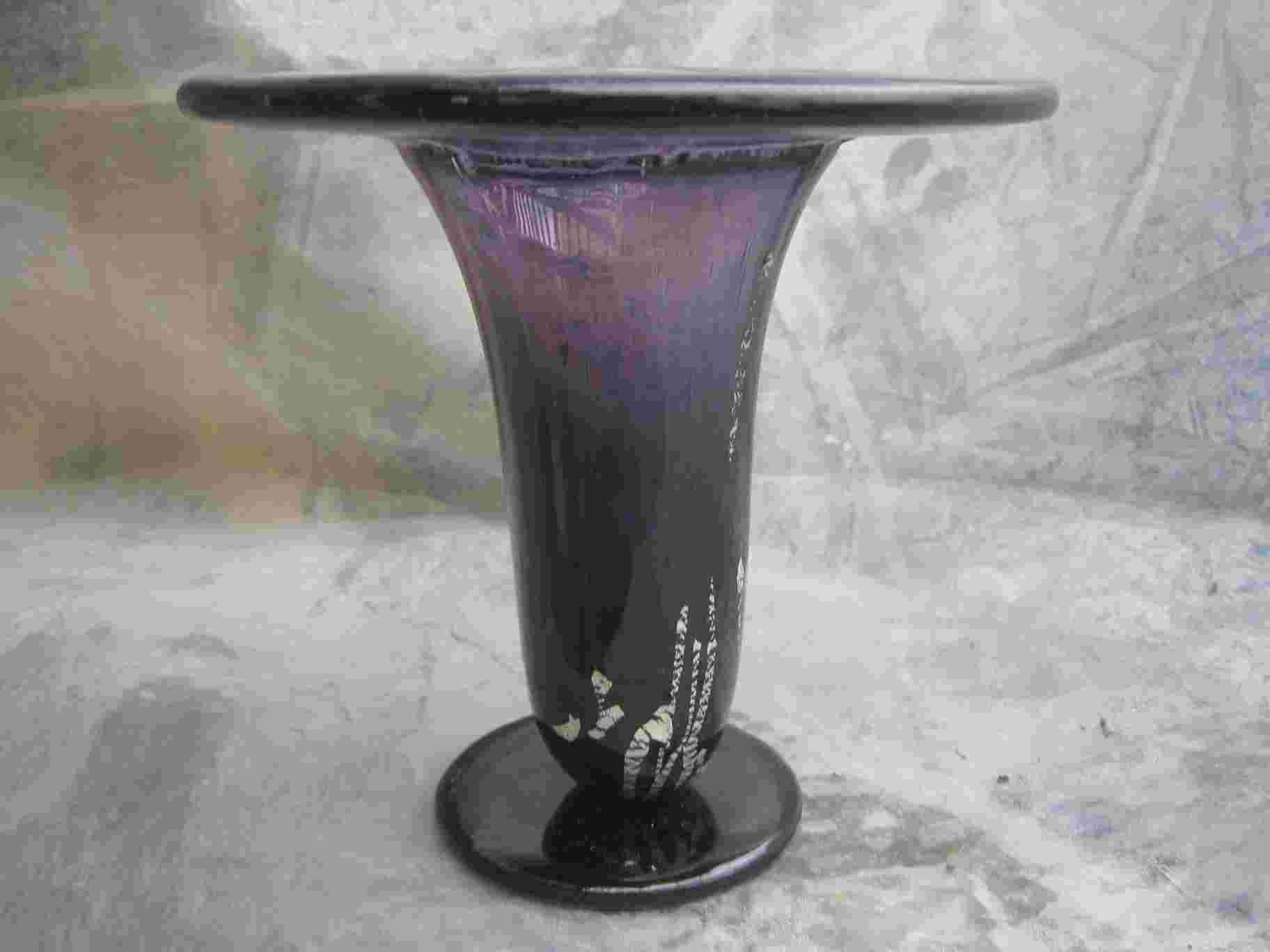

This is the third time I've tried to update my post. The previous two said it was saved to drafts, but I've looked and looked and can't find my drafts. So here I am again. I was having issues with my photos not posting, too, so I reread the forum questions... which is always a good thing to review.
So the "test" glass was two layers prefused. Then I decided I needed one more layer of glass and opted for Tekta. I cut the same size as the two fused were originally. I figured it would fuse while slumping through the hole. You can see in the image of the two parfait glasses that the test one has a noticeable lip from the Tekta. It also as more lines. The first of my "real" parfait glasses I fused three layers and slumped them. You can see the surface of the rough parfait shape is very smooth. The air bubbles in the three sheet fusing were small, rather evenly distributed. [img]1st%202%20parfait%20glasses-sm.jpg[/img] You might also notice that the "test" glass has lime green Colorline that I used to write the names of the bride and groom. But it remained mostly in the area that will be cut off. The "real" glass I used silver foil. I like how the silver foil turned out, but would have liked the silver to come up higher on the glass. You can see some of the silver turned yellow... which I don't mind.
What I am posting about now is the air bubbles that began as small seeds, are now stretched out and I am concerned about them being points of weakness. I am thinking if the air bubbles are on the surface when I cut the excess ring off, it will leave an open air pocket... which perhaps clear Colorline could fill. I'm not sure if firing the Colorline will ruin the shape of the parfait glass, but that is one of my questions for this board. Will it? Is there anything that folks do if there is an air bubble where you don't want it?
[img]ParfaitBubbles-sm.jpg[/img] Here you can see the seeds of air that have stretched to long lozenge shapes.
When I cut off the lip I'll post about that. First I have to make the second one. I am pleased with the evenness of the sides. I think the advise of low and slow was very good. I know I could have fired it hotter, but it seemed a good idea to let the glass get nice a gooey over a long time so more of it was inclined to flow down the hole. Thanks for that advise. More when I've made the second one.
Oh, BTW, I've decided that while the newly weds thought the glasses would be too small, I think they will be an elegant size for ice cream and less likely to foster excessive servings, which is nice for all of us. I'll measure their capacity when they're done. I am really enjoying this learning experience. I also am grateful to all who make suggestions. Thank you.
