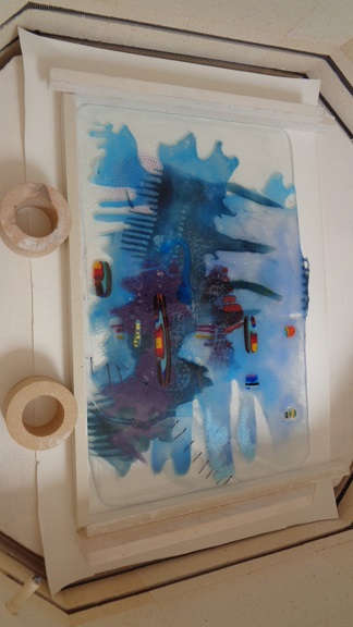

H. 1. Here one can see how far the piece is from the kiln elements....
2. I have marked In black where the piece had broken....
Due to the very conservative schedule, I shall be done tomorrow night, or the day after tomorrow morning.
I found my polaroid sheets. While transferring the glass - it broke where the crack was [!... ] not too surprising. Still checked for incompatibility which was not . No incompatibility.
I photographed with my camera, but can't unload the photos. My computer man did something that disables me from downloading photos. I'll have to find someone else for now.
I'll keep you posted when there will be news
Thanks for everything,

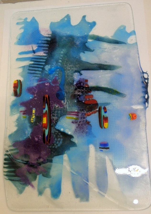

Re: TO RE-FIRE OR NOT TO RE-FIRE
Hello,
Please see the photo I put on my previous post.
After 32:07 hours I took out of the kiln ONE piece.... [quite an exaggeration in conservative schedule]
Of course I am happy, or shall we say satisfied, but still quite suspicious, I really do not know what will happen in a week time, or longer time or less time.
I also checked for stress , found none.
Thanks for your help and co-operation.
Now got to go to fix another one - whose design I do not like, but I feel I can not continue, unless this one will satisfy me.
