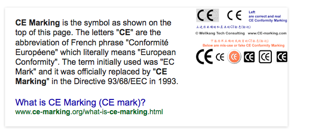

The internationally accepted meaning of this symbol is this:
When challenged Chinese exporters say it means 'Chinese Export.'
