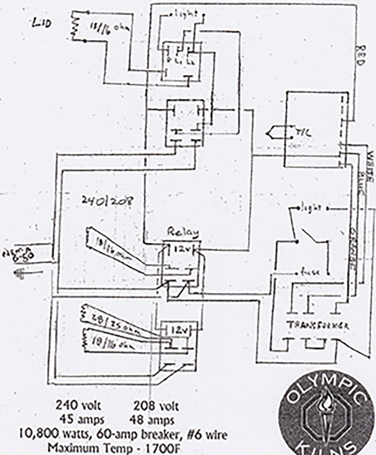

Here is the schematic that Olympic sent. Lid relay and rheostat on top, notice that one of the side relays control one element while the other controls a pair of elements. Couple of questions for the experts here:
- Why would the bottom relay that controls a pair of elements have one element with a 25 ohm value while all the others are 16 ohm?
- If I were to measure ohms (multi-meter across both ends of an element, isolated from rest of controller, power off, disconnected from wall, etc), what values would we expect to see? Anything relative to the values in the schematic? All over the place due to (unknown) times fired?
- If I replace all elements at the same time, would you expect that 25 ohm element to be a different PN?
- At what point does a high or inconsistent value (compared to the other elements) dictate replacement of the elements? In other words, what range of values is acceptable?
Tony, assuming that the 3 relays are numbered 1 thru 3, bottom to top in the schematic (the top component with the light is the rheostat) it seems that you are suggesting a switch to turn off/on the side elements should be across the LH 12v side of Relay 2 and the RH 12v side of Relay 1. Is that correct?
Thanks for the help, trying to careful here....

It's interesting that Olympic is using a single zone of a three-zone controller and wiring all three relays in parallel. I suppose it would allow them to use a single-zone controller without having to change the wiring.
To answer your questions, one element has a higher resistance because it is longer than the others. I'm sure it would have a different part number. With the power off, and the kiln unplugged (there is always power at the relay even with the controller turned off) you should be able to measure the element resistance at the relay. The resistance will only change if the element is damaged in some way. An oxidation on the element is normal, but severe corrosion will create a hot-spot in the element and will eventually fail. Elements will last for years if they aren't severely corroded or mishandled. I would expect an element to be within 3, maybe 5 ohms of nominal unless it was damaged or otherwise compromised.
From this schematic, you can break the red wire between relays 2 & 3 (just to the right of where it says 240/208) and install a SPST switch. You don't need to break both sides.
