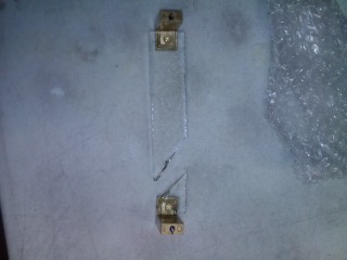

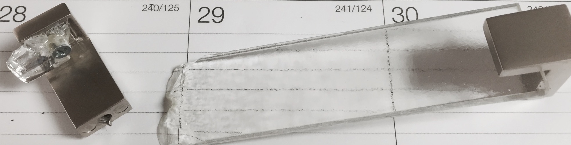

I am having some issues with broken glass. I make cabinet knobs and handles. I introduced a new collection of hardware in January. I have probably made 1000 pieces of hardware since then, and recently 4 of them arrived at the customer with broken glass. I don't think it was because they were bounced around during shipping, as we pack them very well with bubble wrap. I think it had to do with the way they were fused. We have two styles -- one is 6mm Bullseye clear glass, and the second style is 6mm clear Bullseye glass layered on top of 3mm Bullseye white or gray glass (for a total of 9mm). We fuse them 400 degrees per hour to 1000, no hold. And then AFAP to 1370, no hold. And then AFAP to 960 (recently changed to 970) and hold for 1.5 hours (anneal). And then 75 per hour to 750 and turn off kiln. Attached are two photos of broken pieces. You can see that we have holes drilled into the glass (before fusing), and we use a screw to attach the glass to the metal base. We do not screw the screw in very tight, as we use glue to hold the screw in place. In fact, with the handles, we intentionally do not screw it in all the way, so there is not any pressure from the screw on the glass. Photos of broken glass attached. Would appreciate any help.

Doesn't look like a fusing issue to me. More likely handling of some sort or something heavy dropped on the place where it broke.
Be interested to hear what others think.

Blunt force. Even incompat doesn't look like that.

Thank you both for your thoughts. The reason I had thought that it might be a fusing issue is because we pack these up extremely well when they ship out...bubble wrap, and then lots of padding in the box. It seems so unlikely to me that it could have broken during shipping. But I certainly could be wrong.
