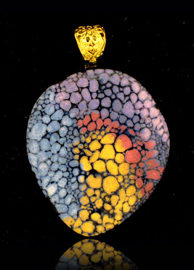

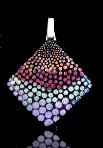

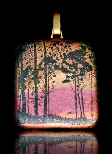

My wife does a lot of mica design work and uses clear ink(they sell this for use with stamp pads). Seems to really stick the mica tight to the surface. Different brands really work out differently. We don't like Fusemaster, seems to have some kind of additive than can boil if at all too thick and gets clumped up in the package even with a packet of silica gel added to ensure dryness
. Delphi's gold mica is "ok", but not nearly as gold as what we get -> -> Currently very happy with one from a soap makers supplier, ebayer "countryfolksoap". Their "24k gold" has got some really staying power, routinely taking to 1440-1450. Flakes are a little bigger than some. Their PInk, bronze and copper shimmers do pretty good( Pink looks killer in the veins of a brown crackle item, imo. Have also done that against a soft orange). Their Olive green has no staying power at high heat.
