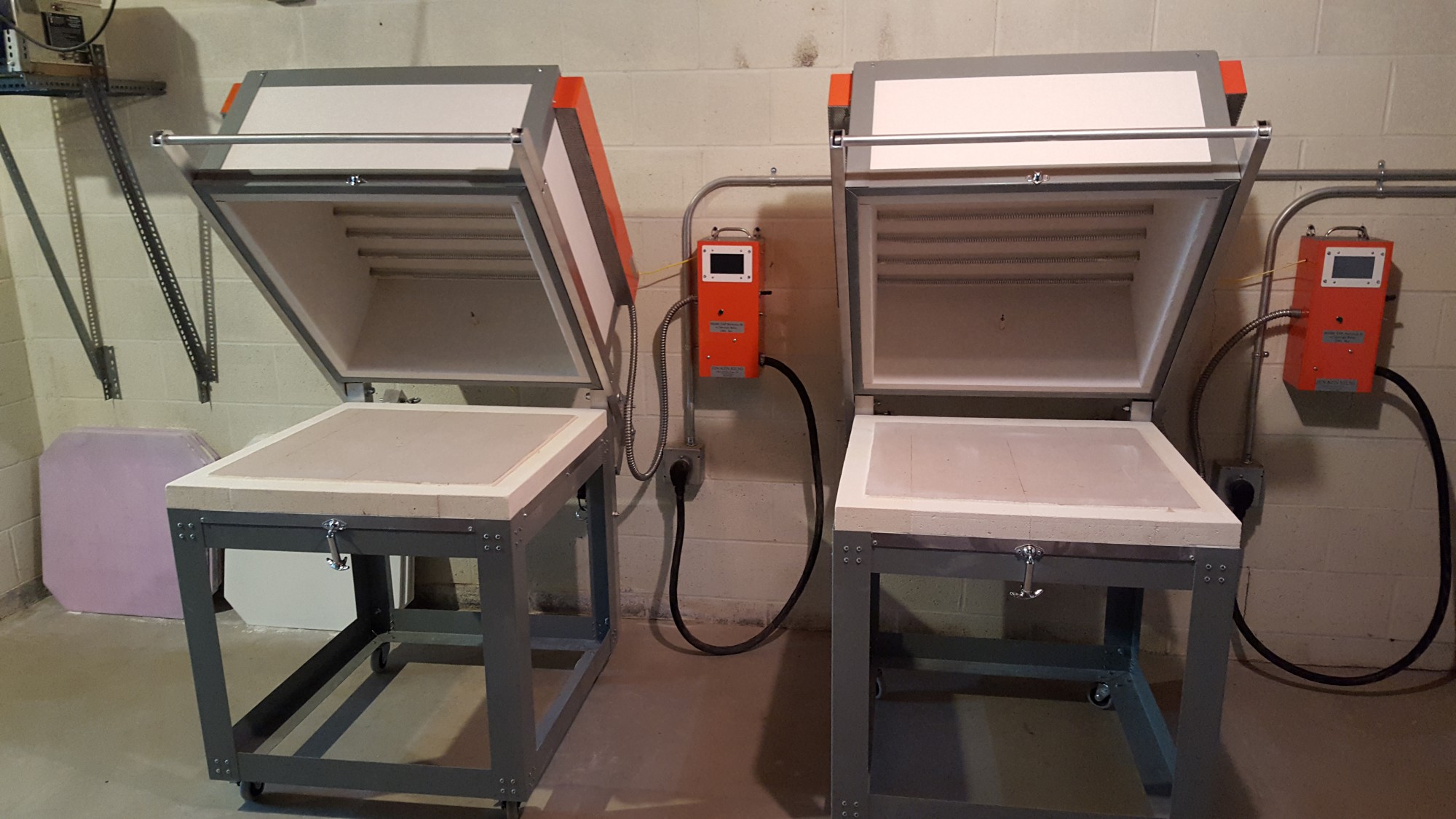

I have 2 Jen Ken Profusion 26 kilns. I bought them over 2 years ago and have had no problems. However, after the first firing one developed a small crack in the exterior side panel (only on the surface). They sent me patching material to fill the crack ( the same material as the fiber) and it's been fine since. I bought the tap controllers and the mercury relays.
David

David - Thank you for sharing your experiences with the profusion 26. I sure would have been upset if a new kiln developed a crack after one firing. Do you know what caused it?
