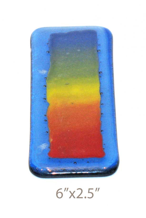

Sorry I am late to the party, I've been ouot of town.
Heck yea you can combine enamel or stains with powder.
I do it all the time.
