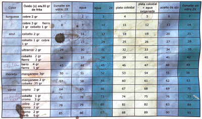

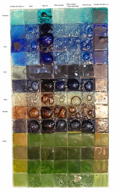

I have attached an image of the documentation she has regarding how much of each oxide she used with 30grams of frita (frit en español) along with the sample plate with the results. So this does work, she did do it but I cannot seem to find any information online about the details of how its done at full fuse temperatures. I know about making furnace color batches in a hot shop, adding oxides to the color mix from a source like Spruce Pine https://www.sprucepinebatch.com/glass-batch/ and heating up to 2250-2400°F during charging, but that is not what I'm trying to do here.
