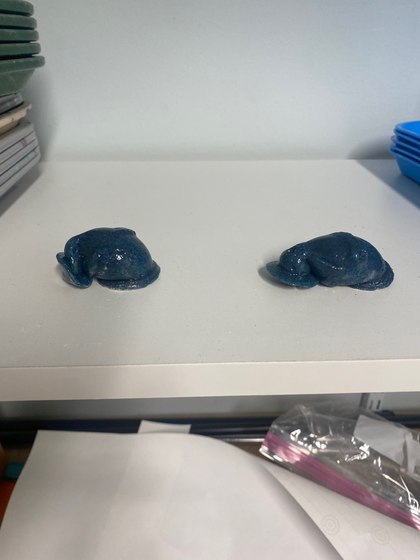

I am a glass fusing instructor and I have a student who is trying to make game pieces using the Freeze and Fuse technique. He has made his own silicon mold and the pieces are made from powder frit that he ordered from the local glass supply store. The pieces are roughly 1 inch wide and about 2.5 inches tall. The problem that we are having is that the pieces are falling over when fired.
This is the schedule that I used the first time
1 200 400 .30
2 400 1320 .35 (for the second fire I adjusted this to .25 with no success)
3 9999 960 .60
4 200 700 .0
5 500 200 .0
How can I keep the pieces from falling over? Are they too tall to accomplish a successful freeze and fuse.
Any help would be much appreciated
Thanks

They're most likely way too tall.
- Location: North Carolina
Re: Help with freeze and fuse
Usually any type of undercut will fail.
Also, tall pieces will do exactly like yours did.

Would they fall over or loose their shape if the powder frit was mixed with CMC?
Mark Hughes
- Posts: 1534
cmc burns off at about 900 F. You are left with frit which behaves like you experienced with FNF

Since you obviously have a negative mold for the object and it appears to be two parts, you could turn it into two open face casting molds.
1) Make a plaster or resin positve in it.
2) Use the positive to then produse a casting negative. If the positive is sturdy you could use it over and over. The casting mold will probably only last for one firing. With practice you can produce the two halves that could be mated (glue or careful tack fuse).
The professional way is to do a lost wax casting which you can research yourself.
Jim
