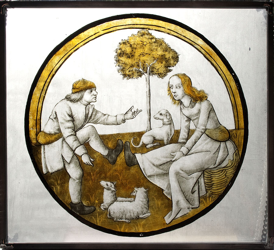

Hi all, well I've had a few delays, but I finally finished my first piece recently. It's a copy of the "Game of Quintaine" roundel in the Met's cloisters in NYC. So, as promised to Don, here it is! I'd be interested what you all think. Cheers, Sasha

Don Burt
Posts: 579
Re: Glass Painting & Firing Questions
Post by Don Burt »
I think you did a lovely job. Your glass takes stain well.

Post by Bert Weiss »
You got the olde English thing just fine.
Posts: 633
Sasha, your reproduction looks very professional! I put the Met's original beside yours on the screen:
http://www.metmuseum.org/collection/the ... rch/469853
Did you use float, as you mentioned earlier? I notice, too, that earlier you'd asked about doing your fine lines last. I think that would cause a problem with any enamels or silver stain as you'd have to fire your fine tracing lines, painted with stainer, at the higher temperature which would probably fry any enamel or silver stain already applied. Jen
Sashaziv
Posts: 15
Joined: Tue May 06, 2014 8:48 am
Post by Sashaziv »
Dear all, thanks very much for your kind comments, really appreciate it! I'm really happy with the piece - it was a wedding present for my cousin, who was very happy indeed with it.
Re your questions Jen, yes it's on float glass. I used yellow & orange silver stain mixed with copper sulphate, as I don't have any amber intense stain, and the original is quite amber-ish. Re the fine lines, I meant the lines as a last painting layer before the silver stain, so metalling of the stain etc. wouldn't be an issue, as the stain would be fired next.
One thing though - the reusche de401 black came out quite greenish on several pieces. I'm wondering if there are more neutral blacks available? (like lamp black) I'm actually going to try some keracolor paints next, they have a few interesting blacks.
