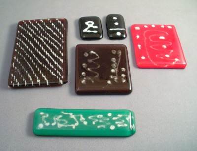

I did some fusing tests with the powder a while ago. They are out in a box somewhere, and I have any pictures of them glowing, just in normal light. I used a dark transparent base layer, drew a pattern with the glow powder on top of that base layer, and capped it with a clear layer. I cut one apart and the power just poured out. I would think that glass powder will not seal well enough. Without pictures, I'm still not sure I understand.

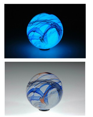

Here is an example of using them in a blown form - this is a marble that is about 3.0" in diameter. The top image is the marble glowing in the dark, the bottom is what it looks like in daylight. If I "charge" it outside in the sunlight for about 10 minutes or so, it will glow like this brightly for a few hours, and then slowing lose the glow after about 5-6 hours.

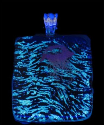

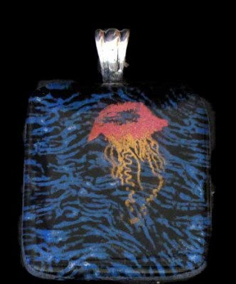

I mixed the powder with Ferro Flux and A-14 to get a screen printable paint.
In Regular light In UV to charge the glow powder
