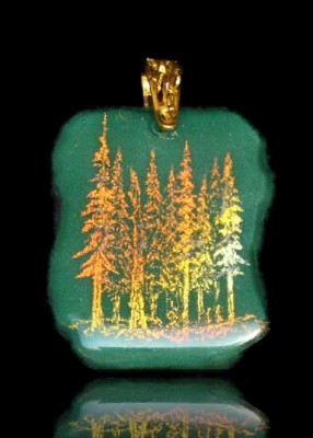

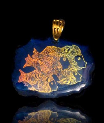

]I feel that the determining factor of crispness of etch on dichro (as animallover seems to want) is the masking accuracy, not the method of etch. Using a photo process creates highly accurate results and ultra crisp lines.
These were created using Armour Etch.
- Schooling fish Zentangle (©Shelly Weaver design)
- Dichro Forest
Re: velvet etch
Posted: Thu Aug 09, 2012 11:10 pm
by Brock
Barry, those photos are awful. You literally cannot tell how crisp or fuzzy the lines are, but they appear fuzzy.
I'd get better pictures. I'm familiar with photo processes and I prefer sandblasting.
