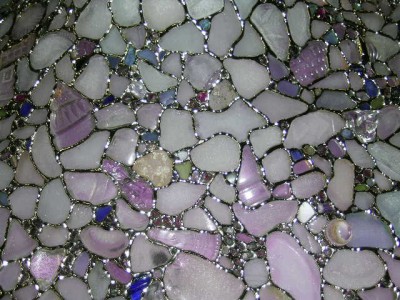

Hey, it's not just for jewelry . . . this is a detail of a beach glass lamp about 14" high by 17" around
