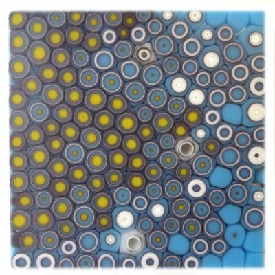

You'll get a LOT of cane from one full (or almost full) pot.......but the number of canes is entirely dependent upon the thickness of the cane you are pulling.
We just hosted two workshops on VItrigraph Cane and Murinni with Nathan Sandberg, and had 5 vitrigraph kilns firing every day. Each pot each day produced an amazing amount of cane - from 3/8" thick to thread-thin.....it depends on the look you want.
You can see some of the finished murinni pieces on our FaceBook page
http://www.facebook.com/pages/Vitrum-St ... 8109661680
![Murinni class 09-2012.jpg (53.71 KiB) Viewed 12749 times A piece made with murinni canes](./download/file.php?id=5436&t=1&sid=24149e16395a3c1c0ad50bac7a17e3f8)
- A piece made with murinni canes
