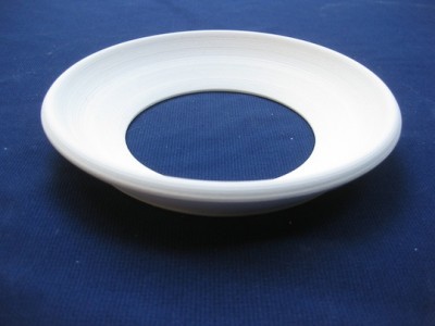

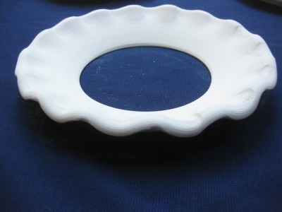

That is why we make molds especially for slumping that are bottomless!! I hand throw them with a variety of sizes and lips.
Here is an example. They last forever!! I started making them after getting very frustrated by commercial molds that not only cracked easily but also the rocking bottoms.
many of you have our molds in your studio......thanks!!

More recently I bought some of Laurie's bottomless molds and these are now my favorites. I don't have to set them on kiln furniture, just flat on the kiln shelf. The bottoms are perfectly flat and my customers LOVE that.

I make all of my molds on the potters wheel so they are all round. Each one is one of a kind with different lips. You actually get the one in the photo on our site.
