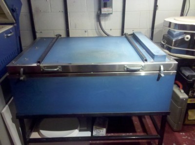

About 2 year ago I picked up a used Denver KL-50D being offerd for sale on ebay on the cheap. The kiln was one of several that a stained glass shop in the Chicago area had used to do a lot of custom glass bending to replace windows in many of the Arts & Craft style homes that were being renovated in the area. While the kiln was 12+ years old it was in remarkable condition due to the fact it rarely was fired above 1300 degrees. All the elements worked and fired evenly, no broke or cracked mullite element suspension tubes, no warping of the lid, very little rust. Just a bit of discoloration/fading of the exterior paint.

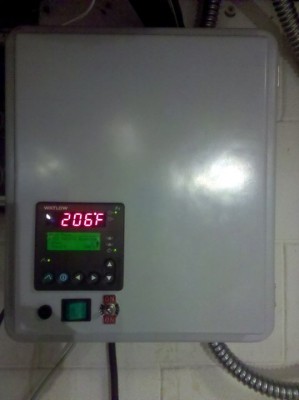

But it came without a controller as the seller was holding on to the Digitry that he used to control several other kilns.

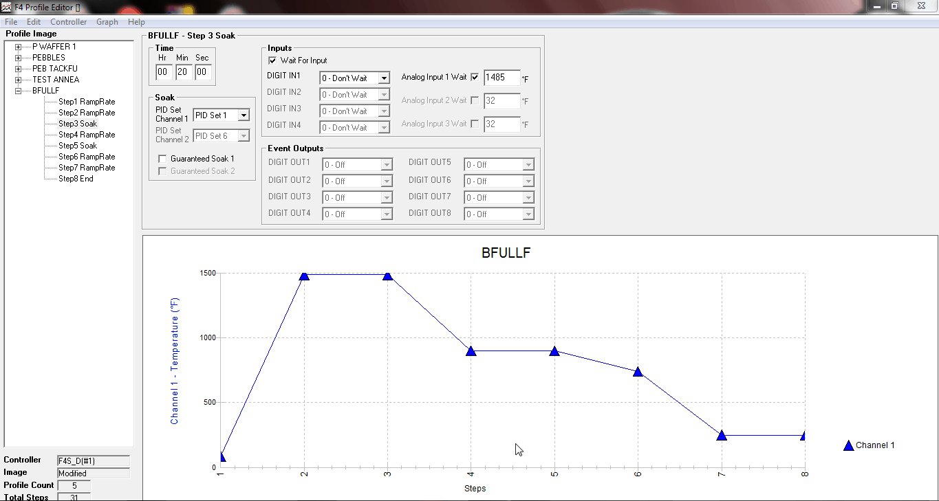

This put me on a path to build my own controller. After a bit of research (surfing the web, Duralite, Joppa Glassworks, posts from various forums, reading Glass Notes, etc), again I turned to ebay and was able to pick up a Watlow F4S PID based controller, the appropriately power rated Watlow Din-A-Mite SCR power controller (solid state version of a mechanical relay), thermo couple /wiring/connectors, and enclosure to mount all the components into.
Out of pocket costs were about 1600.00 for the kiln and all the components to construct the controller and get it properly wired to the kiln.
There was a great deal of time spent learning. Not just about about the various aspects of temperature controllers but also about the various +/- of different kiln construction method/materials, +/- of different power control options (SCR, SSR, mechanical relays), and ways to gain better control over the firing profile to get a specific reproduceable result.
While at some point I may trade out the Denver, I doubt I will ever let the F4/Din-a-mite SCR controller combination go because of the features/control it gives one over the firing profile as well as the relative ease to adapt it to a different kiln environments and yet maintain the same firing profiles for a particular process.
As Marty stated, what I learned in the process of taking it on myself was way more valuable in moving me forward with my understanding of what is going on in the kiln than the new (to me) kiln or controller on their own.

I heartily endorse Al's selection of control instruments. The controller and SCR can be often found used on Ebay and these instruments can last a very long time. I have had a set of used SCR's on my kilns for 15 years without a failure. I think the Watlow devices are a significant step up from Bartlett or Orton. Digitry is good, but can rarely be found for less than full price. The trick is that you have to learn what all the options are and then how to read a serial number to assure you are getting the model that will work on your system. SCR relays require a 4 - 20 milliamp output. Bartlett and Orton controllers do not offer this option. Digitry and Watlow do, among others. The SCR decides to be on or off 120 times a second. This makes the power look and act proportional, which is much easier on the elements, and gives more precise temperature control. They can also be adjusted to lower the high end of power use, if you happen to be too close to throwing breakers or stressing your wiring system.
Al, if my memory serves me correctly, Watlow does not charge for the software you need to interface this controller with a computer. If I am right, this is a significant factor. I know that Digitry does charge for theirs.
