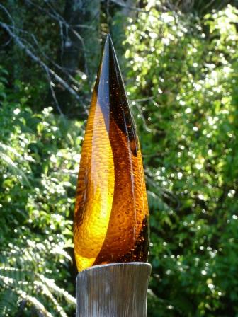

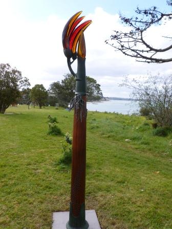

A while back (must be nearly 2 years) I was making a multi media piece which incorporated glass, wood & bronze. I promised Morganica among other people that I would post a picture when it was completed. It has now been installed in a sculpture exhibition in NZ called NZSoS (New Zealand Sculpture onShore).
Originally it had a bunch of glass fruit cast as one piece. I was not happy with it & attempted to refire it with disastrous results. The glass components have now all been cast separately.
Here it is:
You can see many more images on my Facebook page.
Cheers,
Ron
Here it is:
Cheers,
Ron

Thanks all for your kind comments.

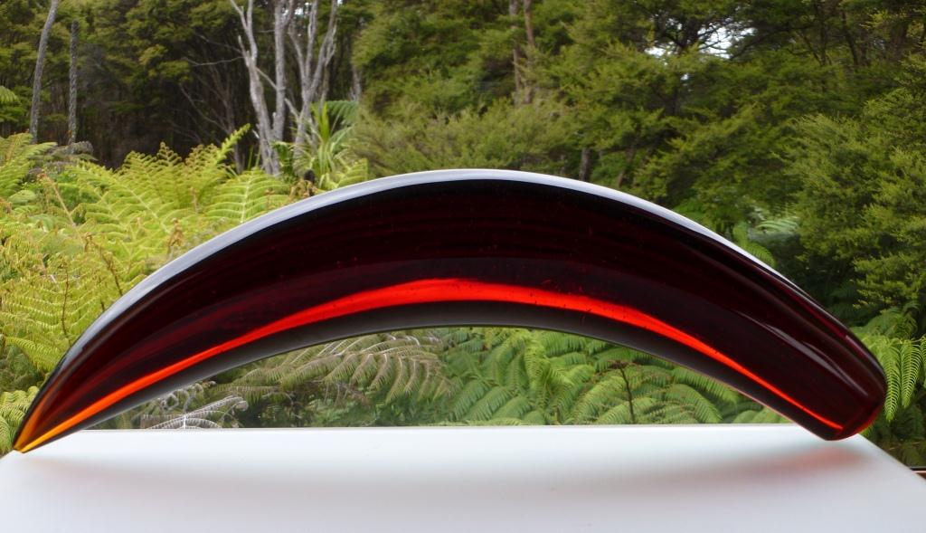

First I'll tell you about the disastrous refiring of the bunch of fruit.
It was done in Bullseye cranberry. After coldworking the piece I was not happy with the excessive amount of bubbles (half bubbles) on the surface of the glass withe many more below the surface. If I coldworked the surface ones off, more would appear so I resolved to refire it in an attempt to eliminate as may of these as possible. After filling the surface bubbles with wax, I reinvested the glass & refired with a long soak at 830c
(16hrs) Unfortunately on the downwards ramp, the mould cracked & leaked half the contents over the kiln floor. This wouldn't have been so bad if I could have reclaimed most of it, remade the piece & topped up with new glass to replace that which was lost.
Unfortunately Bullseye cranberry is a striker & on the second firing it had gone liverish so no hope of using any of it again especially for a third firing.
With the new work I made each banana as a separate unit so I was able to use Bullseye amber on two of them & Gaffer orange red for the other two.
To eliminate bubbles I cast these horizontally in open faced moulds & carved off the excess glass after firing.
The results were much more pleasing.
I'll make another post to give the specs of thework.
Cheers,
Ron
Cheers,
Ron

Re: Gondwana Banana
Here are the specs. of Gondwana Banana:
Height: 2500mm
Width: 500mm
Materials:
Glass: Leaf bud: Bullseye casting billet amber 3.8kg
Banana x 2: Bullseye casting billet amber 3.6kg each
Banana x 2: Gaffer lead crystal orange red 5.1kg each
Total glass: 21.2kg
Wooden pole: jarrah (Australian hardwood) 1670 x 180 x 180 36kg
Silicon Bronze
Crown: 950 x 500 x 500 17kg
Roots: 950 x 450 x 450 17.5kg
Total bronze: 34.5kg
Cheers,
Ron
Height: 2500mm
Width: 500mm
Materials:
Total glass: 21.2kg
Silicon Bronze
Cheers,
Ron
