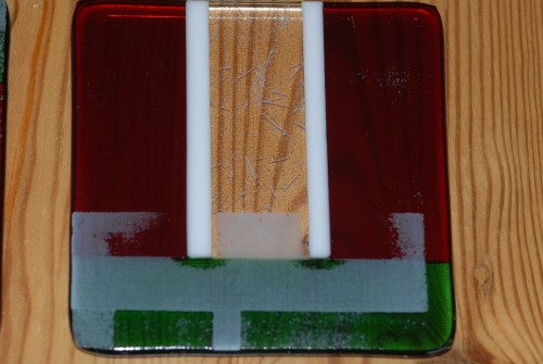

Here is a pic of what I am talking about (Not sure if I understand how to send the picture, so here goes a good try). I am using 6 coats of Primo Primer and this was the second time I fired on the same kiln wash application, so it was completely dry. The etching was actually there, prior to using any of the removers. I am thinking it is caused in part by the PRIOR piece that was fired, which was white opal glass, so what you mention makes sense. The piece that is in the picture was fired at 1470F which seems reasonable, but maybe I am wrong. At any rate, looking at the picture--can you tell if it will fire polish, now? If not, I will use the diamond hand pad and as a last resort, find a nearby sandblaster to use. Making a new set would likely be a lot simpler!

I apply a coat of kiln wash, then dry with hair dryer, apply the next---dry with hair dryer, until all layers have been applied, so it doesn't happen to me. The finished product is very smooth and never flaky. The first piece I fired came out beautifully with no residue. The next day without re-applying new kiln wash, I fired the project that you see in the picture. I honestly believe my problem is related to the first piece, which had white opal glass in it. The etched pattern on the piece in the picture practically mimics the white pattern of opal glass used on the first piece. It is as if the white opal glass weakens the kiln wash....or something like that!
I took your advice and used a diamond pad on each piece to remove whatever was there. They are back in the kiln for a fire polish, as we "speak" . I am hoping for the best turnout, but lesson learned...I won't use a kiln shelf more than once again without removing the old and apply a fresh wash.

Nope. I don't put on a specific number of coats, because after all the the slurry can change from mix to mix. I put on enough coats so that I can no longer see the color of the shelf, doing the usual alternate 90 degrees between coats. I normally pre-fire, (not if I am making magnets or small blanks) then use as required. Because of the base glass I normally use, I get anywhere from 6-10 firings. The effect on the bottom of the pictured piece is where that piece overlapped where a piece had been fired earlier. The KW is "stickier" where it has already had a piece fired on it. You can use this to your advantage. I once placed 121 magnets precisely on a shelf, fired and removed them then placed a large square piece on that shelf and fired it. That resulted in the back of the large piece having a pattern of squares on it, where the magnets had been. If you're going to use a shelf more than once, and you certainly can, just fire the large pieces first and work your way down to smaller pieces. You will not get any marks on the back that way. When doing this use the lowest possible temp/time to achieve your result.

1470° for a top temp in my kilns would be too hot for what you're doing. You didn't mention how long you held at that temp either. My top temp for a full-fused, two layer piece is 1440° with a 10-minute hold.
Your piece looks over fired to me, due to those sharp little points on the corners.

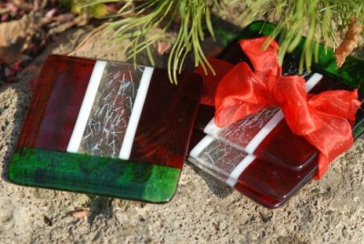

Thanks to you nice people for your suggestions. I feel that I learned a little sumptin here and am glad that I got up my nerve and joined all of you fine artists. Here are pics of the coasters after coldworking with the diamond pads and a fire polish.
