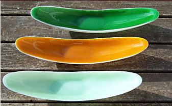

Hi
A long time ago I saw these glass bowls, and fell in love with the shape. Did contact the artist in case he/she wanted to share where to get the mold, but reply was that it was a found object.

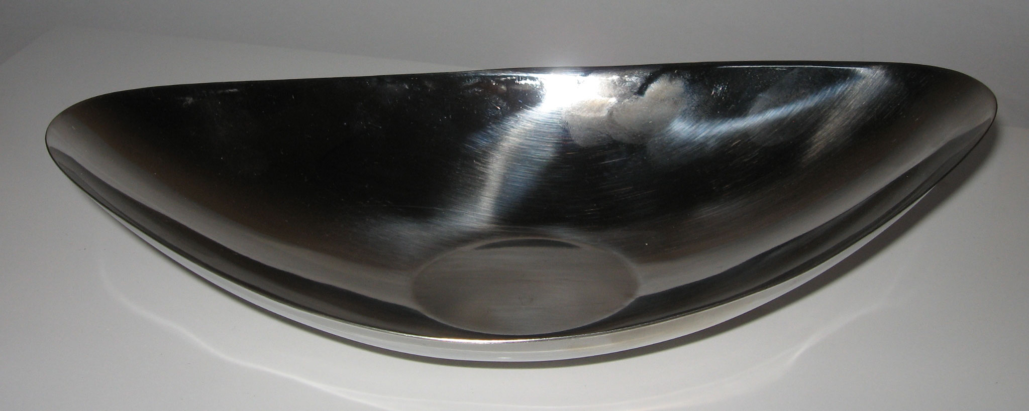

Haven't been lucky to find something as nice as those, so thought would try shape below:

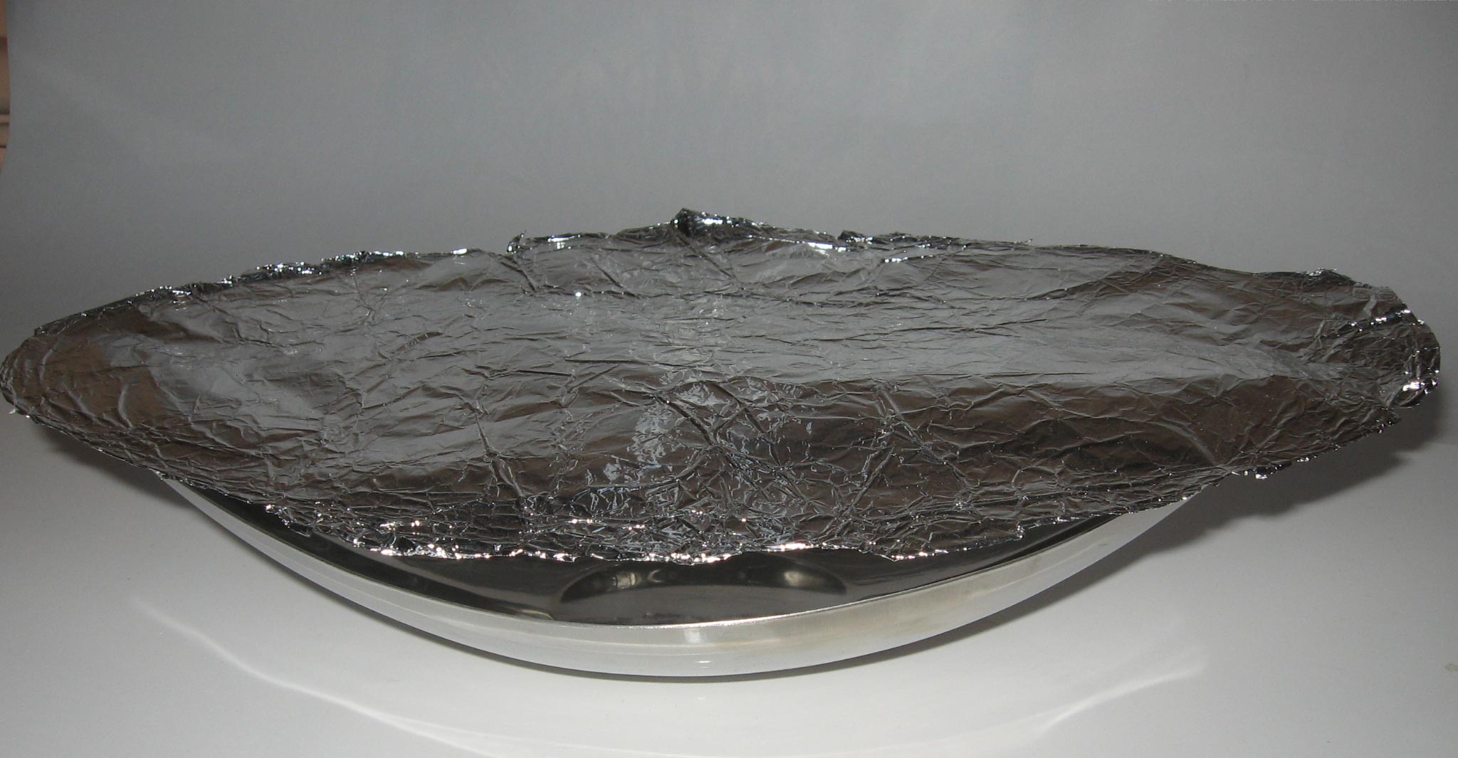

Lined it with aluminium foil to see how big the glass piece has to be (a trick I had read on this board). As you can see in this picture, the glass should be quite a bit longer and wider than the mold itself.
It is the first time I am attempting something like this, and can't quite figure out how to support the glass so that as it bends it falls into the mold and somehow works out all right.
Is it very tricky to do? Is this done with kilnwashed posts? :-k
If yes, advice on how high above the mold would be great. Does anyone has a picture of a similar set up? The pointy ends of the mold are about 1" higher than the lowest part of the side curves.
Don't really expect the first one to be great, just to avoid a big disaster while I am learning 8-[
Many thanks, seachange

Hi Seachange,
Lovely shape. Here are a couple of suggestions:
1) start out using float glass to get the glass size prior to slumping right. Don't worry about annealing them ... they are tests only.
2) The glass will stretch while it slumps so for a first pass I would cut the glass about 1/4 inch longer on each end and about 1/2 wider at the widest point for each side.
It may draw in at the central part where it is not supported... just guessing. Using this approach the edge of the finished bowl will be slightly inside the edge of the mould.
3) If the glass overlaps the two ends of the mould... and if you position it very carefully so it is balanced then that is all the support you should need.
4) heat it slowly ( 300f/hr ) until it starts to bend and then hold it there so that it slumps very slowly. It may take 30 to 45 minutes for it to slump into the mould. If it looks like it won't slump in that time increase the temperature 25F .You'll have to peak in the kiln to see how the piece is slumping so be careful to wear natural fibre clothing... cotton... eye protection ... all the safety concerns.
You might have to tweak the shape of the window glass glank a bit but once you are happy then do the same with you art glass and adjust the schedules .
Best of luck.

Hi Morganica,
Have 2 questions.
a) When you support the extra large blank on the fiber board, up to how much extra border does this system allows you to add?
For example, with this mold, the alu foil pattern shows that I have to cut the glass 3/4" all around larger than the bowl edges, to end up with glass bowl similar to mold size.
Therefore, if the fiber board hole is cut to exact mold size, I will have a 3/4" border resting on it.
Will this 3/4" wide border slide down, or is there a risk that it might grab on the fiber board?
Should I cut the fiber board hole a bit bigger than the mold, so that only about 1/4 inch of the glass rests on it?
b) How do you shape the inside edge of the fiber board drop out ring?
Like this /__ (angled towards the board), or like this \__ (angled towards the hole). or vertical l___ ?
seachange
Posts: 223
Re: how to support glass for this mold?
Post by seachange »
Many thanks for all the replies, they all make sense to me.
Ideally I'd like to get the glass bowl about the same size as the metal mold (as Bob asks, in this case size does matter :) ). Because of the narrow width compared to the depth, kept thinking that if I cut the glass just to size the resulting bowl will be rather small.
Remembered reading in the (now lost) archives, something about supporting the glass on kiln furniture on the very edge of both the glass and the kiln post, so that as it starts slumping it slides - hopefully gracefully and evenly - off the supports and into the mold.
The "even" part has always concerned me, Morganica's explanation of support all around seems a lot safer to me.
After reading all your suggestions, the action plan is to start as Bob suggested with float. Will have to vary the firing schedule for the final piece, but it will be a beginning. Have to learn to cut ovals at the same time, so waste glass is a very good idea.
Cut glass to the size of the alu foil, and support it with kilnwashed fiber board above the mold, as Morganica says.
Use coffin kiln so I can look from the top and center everything properly.
Use slow schedule and peep often.
Hope I am not forgetting anything important [-o<
