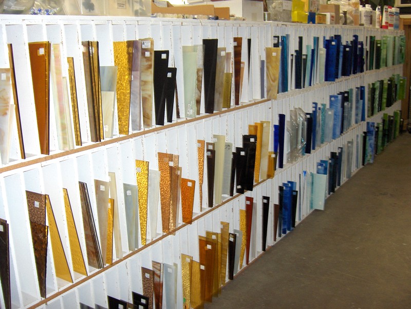

No, Rosanna, I think AndyT wins...that looks like Bullseye's glass racks!
Re: Building a glass storage cabinet
Pretty much a mix of everybody's glass. And, that's just one side. Same amount on the other side and behind and half sheet racks at the back.Morganica wrote:No, Rosanna, I think AndyT wins...that looks like Bullseye's glass racks!
