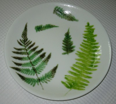

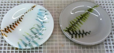

I'm on the mailing list for a glass studio where I used to live, and got these photos for an upcoming class. Unfortunately I no longer live in the area. Can anyone tell me how this is done?

If I remember correctly, use Glass Line paints over real fern leaves. The recommendation was to vent your kiln until you reached 1000 degrees, then fire as normal. It was featured in one of the glass magazines. Hope this helps.

H haven't done it but I did read a process somewhere. The leaves (they may have been pressed and dried first) were sprayed with hairspray and powdered glass was sifted over. May need further applications of hairspray and powdered glass to achieve opacity and colour blending. Can't remember what happened next but sticking it down on a piece of glass, I'd place the leaf side uppermost, and burn the organic matter off with a slow climb to 500 deg C should do it. Cap it with clear glass and full fuse. Might need some experimentation.

Yes, I did, but I'm not sure that's the process. The plates in the photos are much brighter and clearer than the ones in the article.

Well... he is fusing on blackdaffodildeb wrote:Yes, I did, but I'm not sure that's the process. The plates in the photos are much brighter and clearer than the ones in the article.
I wrote a blog post of my own experiences with this. If you use light colored glass, and make sure you are using opal frit, I think you'll get the intensity you're looking for:
http://jestersbaubles.blogspot.com/2010 ... -fall.html
Give it a try. There's not much to lose by experimenting.
Re: Fern Leaf Fusing
I have one somewhere not quite finished, if it turns up I'll post a photo.
I learned the method directly from the writer of the tutorial.
If you use a lighter opal (I used French Vanilla) and really get the powder application thick and even it will be just as vivid as the photo above. The powder you sift onto the leaf first becomes the outermost layer when fused so design accordingly. Use a sterdy leaf or figure out some way to strengthen it because it is tricky to transfer it after you add the powder. If it isn't, you need more powder. Hint: paint mixing sticks work well for some leaf shapes.
I'm not sure if the tutorial includes this or not. To get the clean edges it helps to mask and sandblast after you fuse it. Cover the parts of the leaf image you wish to keep with something, I think I used glue, and sandblast.
The look in the tutorial is intentional, it is irregular and imperfect like a fossil leaf.

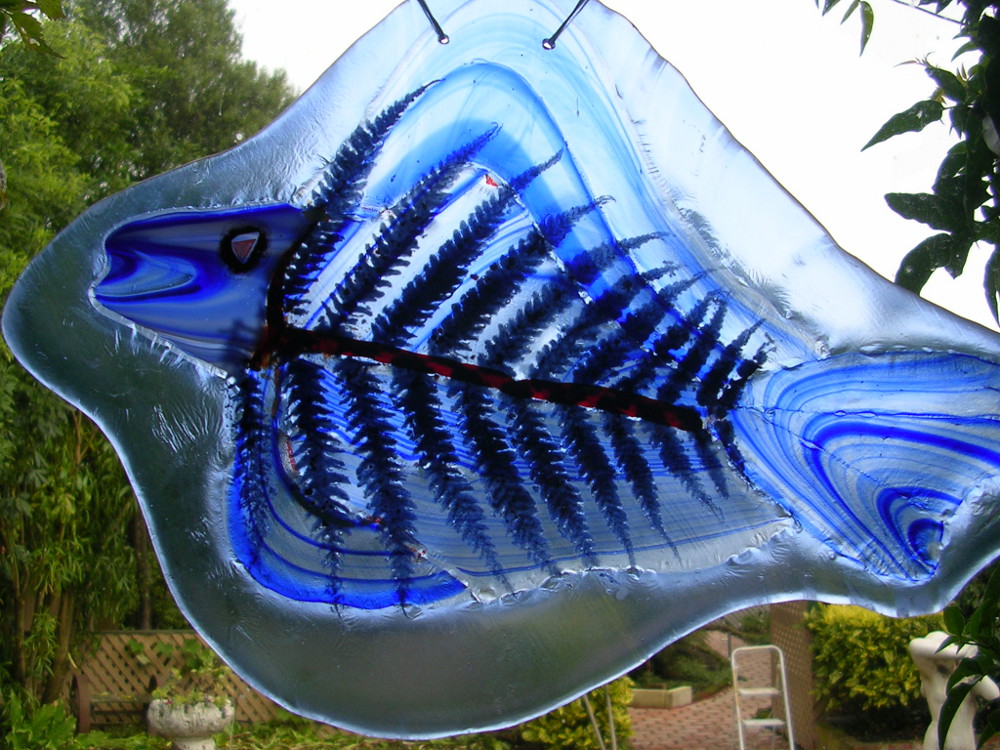

Consider applying glass paint to the piece with a paintbrush? A fern is a whole lot of simple shapes in a simple pattern. Just take your time. Or ask a six year old to do it for you, before she learns to fear drawing and painting.
http://www.burtglass.com/fern_detail_2.jpg

I have been doing this for a few years. I use hairspray and Thompson's enamels along with glass powder. I trace around the blank on the fiber paper and put the coated leaves (let them dry first) directly on the fiber paper. Put them glass up or down. If you are using a couple of layers of enamel/powder, remember that what ever glass is closest to the fiber paper will be on the top of your design. If I am using a lot of organic material, I use 1/8" fiber paper instead then flip and fire after. I always have to tweek the design a bit after anyway.

i read the question on the fern leafs,,some thing i have tried,,,while i am very ,very new at using a kiln,,(note the devitrification), i used a water based wood polish, brushed over the leaf (after sandwiching it between 2 warm shelf's to get it flat)
then added two layers of fine flirts over both sides .the wood polish drys quite fast and very hard , if i use it on glass and add flirts i can brush it with a stiff brush when dry.,,the biggest problem i have found is air bubbles...but then i don't really know very much as yet about firing ,,as you can see
