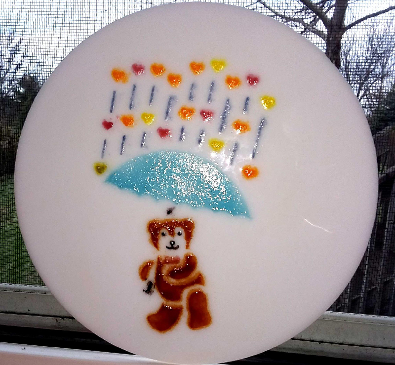

Old thread but I couldn't resist. We crush and cast many of our failures into various hand sized trinkets - sunfaces, butterflies, flowers, feathers, etc. My wife gives them away as an incentive in her school store (teacher) and we have our grandkids paint them with Glassline when visiting. Stuff that size doesn't thermal shock easily so usually we can do a 2-2.5 hour turn around in the Caldera. Kids love a glass trinket. 10 yr. old grand-daughter wanted to try a frit painting so I got this stencil and assisted her with the powder vibe and cellulose gel - present for her 4 year old brother.

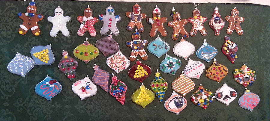

Water jet cut glass items we brushed with CMC and then powdered with frit and fired, a few hundred beads made from small cut or grozed scraps and some larger frit. Add 17 adults and children after Christmas dinner . Add some Elmer's glue, wood toothpicks paperplates and a few colors of Glassline. Fuse. Bails attached with E6000 the next morning and we had happy campers.
It can be done.
*Tip: have your participants work on paper plates they have written their name on, then photograph each plate before loading kiln. Makes for less confusion on who did what.
