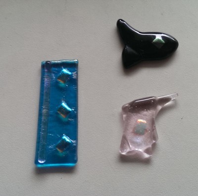

Love dicro!!! So I've been playing with it. Mostly abstract play pieces seeing what the different bits do and how they react with regular glass and iridium and I'm generally enjoying myself and have a pretty well worked process with my microwave kiln. I have generally had a bunch of success with the dicro getting much richer after firing. You can see a few examples in the "squares good.jpg" image attached. This all works at just past a tack firing and full fuse.
- Squares good

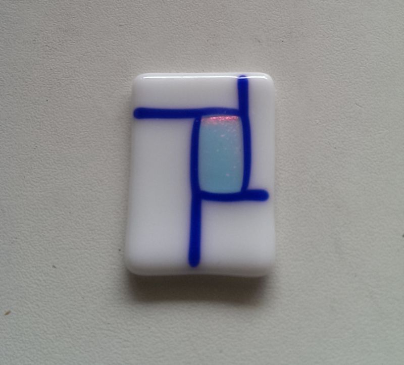

Inspired by some 1920's abstract I thought I'd try something I've been wanting to do for a while - see "20s abstract.jpg" The dichro is not very prominent regardless of how you swing this in the light. Although there was some shrinkage of the dicro layer leaving a bit of clear before the stringers it's still now as prominent as the black cherry on black I'd used before, or the anything else on clear in the previous image. This was pretty much a full fuse.
- 20s abstract

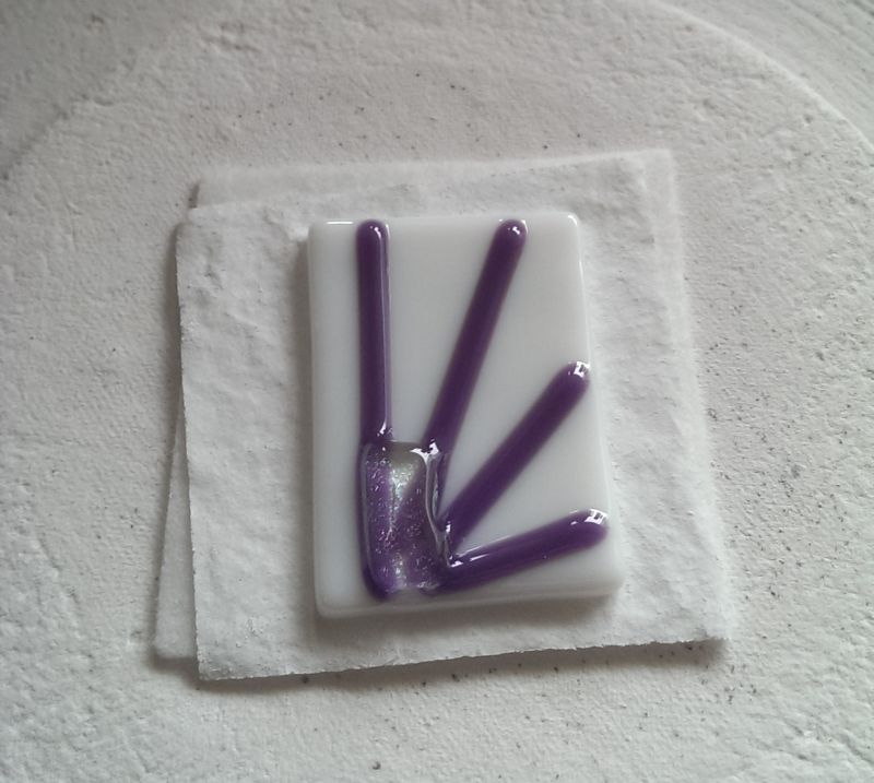

In another one I tried I put the dichro on top of the stringers just past the tack fuse and again, very underwhelming dichro. "good morning.jpg"
- good morning
