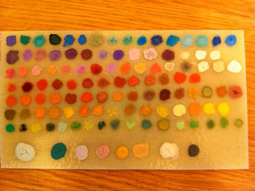

I ran a test with 110 mica powders and found that most of them lost color at fusing temps. I did find a few winners though... I only tested capped and have been told the colors will act differently uncapped. I dread running this test again (uncapped this time). does anyone have any input for me on this? specifically uncapped mica keeping color?

I tested some Pearlex, TKB Trading, Perfect Pearls. went to 1490 and used hairspray as my medium. if anyone is interested I could post the info for the"winners".

I tested about 110 mica powders - only a few kept their color at 1490.
I only tested capped, and have been told results will be different uncapped.
Here are my results:
Blue: I tested 16 blues and none stayed blue.
Purple: I tested 11 purples and none really stayed purple.
Pink: none stayed pink.
Green: I tested 17 greens. Pearlex Spring Green stayed about the same shade of green.
Red: none actually are true red, however very nice vibrant color with TKB Hot Step Mama, Pearlex Duo Red/Blue, and TKB Queen Kathryn.
Yellow: Pearlex Duo Green/Yellow fired goldish yellow.
Copper: TKB Passion Orange is a beautiful rich metallic orangey copper, TKB Lovely Leo is a lighter copper, TKB Bronze Mica is slightly tarnished understated but still rich copper, Pearlex Antique Copper is a nice tarnished penny color, Pearlex Super Copper is vibrant.
Gold: the best truest gold is Pearlex Aztec Gold. TKB Verdigris Gold is nice dark antique gold, Pearlex Interference Gold is a whitish sparkly gold, TKB Pisces starts out blue but strikes to a brilliant yellow gold, TKB Aztec Gold is a nice strong coppery gold.
Brown: TKB Swiss Chocolate is a nice rich dark brown.
White: the truest white is Pearlex Micro Pearl.
Silver: none fabulous, most sparkly brightest silver Pearlex Pearl White,Pearlex Macro Pearl a little darker but still shiny silver, Pearlex Antique Silver tarnished silver but appears to have burned away a little.
Miscellaneous:
TKB Sapphire strikes to a darkish but unsaturated lavender.
Pearlex True Blue strikes to a pale silvery lavender,
Flexi Glass Silver is really more of a metallic off-white.
Mona Lisa Bronze turned khaki with an even coating of bubbles.
TKB Patagonia is a pretty brownish plum.

Here are Lori's before and after images.

Haley, I didn't test any TKB whites, only Pearlex. see my photo, 2nd row, last 3. Macro Pearl came out a medium sparkly silver, Micro Pearl came out white, and Pearl White came out a light silver.
