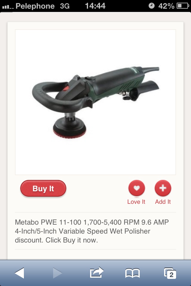

I want to advise you about polisher. It's a long time I want to buy it but stuck.
To buy the dedicated tool it is very expensive and worth of that it will take along time (to import).
So I thought about hand grinder with water support.
But I understood the their are different for some area: like stone, marvel...
So , I have few q:
1. Are these kind of polisher good for glass, and I can get a high level of work.
2 Are there important features I should pay attention to
3what do you think about the one in picther

I had the same question and got good feedback here: http://www.warmglass.com/phpBB/viewtopi ... =2&t=40397
Bottom line, most folks seem to suggest that a flat lap is the better option (unless you are doing large work where you need to bring the grinder to the glass). I am trying to make a flat lap decision now....

DO NOT buy the Apollo saw from Gemini. Good power for ring saw and cutting blades, but the grinder/polisher ruins belts and comes with really low-quality (read as CHEAP) disks. The drive belts are not currently available from suppliers which makes me think I'm not the only person who ruined belts with the polisher and now can't use the machine at all. Wish I had my money back!osnat wrote: maby I will be soon in New York,mabe you can recommend tool and were to buy Osnat
