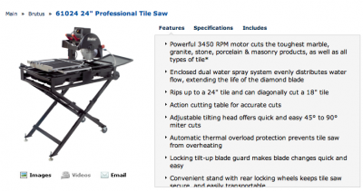

My new saw, the brutus, has water to both sides of the blade. I think it is a great design. You can always add a second little pump and tube for extra water. If your saw is outside.....i would pull a hose over and position it ( a second set of hands would be good for this test) so that there is a small stream onto the blade. If the glass cuts smooth.....no sparks etc then I think the problem is too little water. Just me thinking over a glass of wine here!

Is this your saw Laurie,
http://www.homedepot.com/p/BRUTUS-24-in ... bnW4eeGzKc
Anyone try this beauty:
http://www.qep.com/products.php?c=1&sub=15&prod=7 HEY same saw
- Posts: 321
Re: tile saw issue
Les.....this is it. I love it. I think it is very much like yours but a bit lighter weight. Perfect what what I slice up. I am slices down to 1/4" with a somewhat generic glass blade and they are smooth and clean. Happy glass maker here!!
