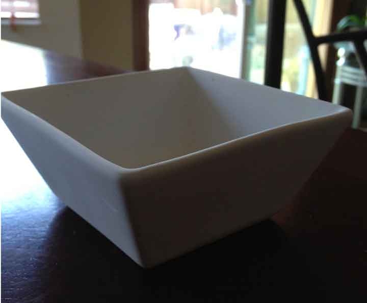

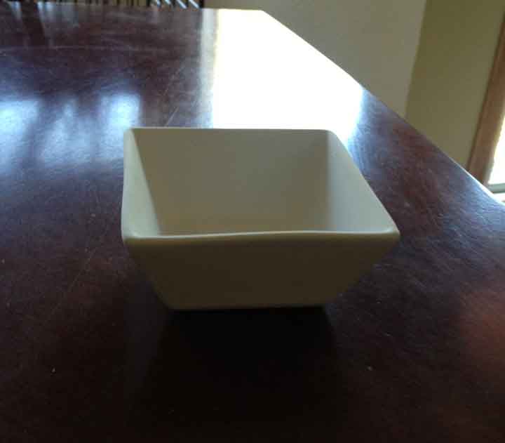

Hello Jim,
I have attached pics of 2 angles of the mold.

Re: avoiding sag in a mold
I don't think you can do better than you did.
Just for fun I would try slumping a circle in that mold.
Jim
Jim
Shapes like that in glass are caused by 2 factors. Glass thinnner than 6mm, when it gets hot enough, will shrink in on itself. This will happen on a flat shelf. Search on this site for "dog boning" . The corners don't shrink like the center of the square. The other reason this happens is when the glass slumps and stretches. It will first pull in on the center of the square as it is easier to move than the corners.
To get some shapes, you have to use a series of molds, each one steeper than the last, and precisely sized and drafted. Karl Harron has been teaching how to work with a set of molds he designed for this purpose. He took years of R&D to come up with the shapes and sizes. You can buy the molds from Bullseye. They are round, not square though. Might be awfully tough to get much better with a square shape. It is all about the relationship between shape, surface tension, and viscosity.
