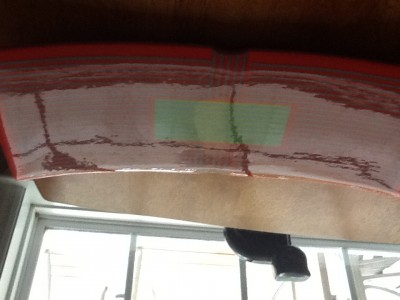

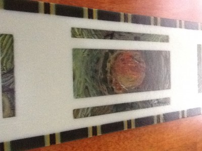

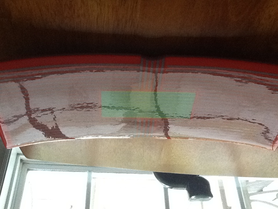

Excellent replies Stephen and Valerie, thanks. Here is the funny part I suppose. After my first strip design firing on thinfire, I saw the texture and assumed that It would fire polish out. And basically it did to the eye, but the surface felt "lightly dusted". So my next piece I assumed that a "light sanding with my red diamond pad would do the job of removing the dusty feel. All it did was shave off the tops of smooth micro mounds left by the thinfire so that the still smooth valleys were now in relief so to speak. So now as you can see in the photo a micro texture remains Thats kinda cool, but both of you guys are right about the level of gloss I desire. Going through the grits. Thanks!
